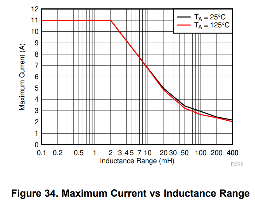

    The key parts that you need to know here on whether the integrated VDS clamp can handle the inductive turn-off are:
    1. The steady state load current going through the inductor (Vsupply / Rload)
    2. The inductance value of the coil
    Once you know these two numbers you can simply refer to the following graph in the datasheet:
    Without the inductance value of the coil it is not possible to determine if the integrated VDS clamp is capable of handling the turn-off. I would recommend contacting the manufacturer of the coil for this information.

    • The diagram is valid for VVS=13.5V ("TI provides the upper limit of single-pulse energy that devices can tolerate under the test condition: VVS = 13.5 V, inductance from 0.1 mH to 400 mH…")
      Can it also be applied for other supply voltages, like 24V in this case?
    • Since the diagram stops at max. 400mH, what would be your suggestions if we had, lets say 1200mH of inductance? The current in the application (90...100mA @ 24V) is much lower as the min. value in the curve.
    Regards, Oliver
  • Oliver,
    It can be applied to the operating range of the device, however at 600mH which is out of the range of what we measured I can say that you will need an external clamping solution like a freewheeling or flyback configuration. The attached presentation (slide 9) does a good job of explaining how to do this with an external diode.
    2019_FAE summit_Driving inductive loads using power switches _cameron.pptx

  • Oliver,
    Is the steady state load current of this device only 90mA? This seems very small for the TPS1H100-Q1 which is rated for up to 4A continuous load current.  If your load current is 90mA I would also recommend the TPS1H000-Q1 as it will be a better price point.
    If you are only running 90mA of load current when the inductor is fully charged then the internal VDS clamp would work in this case.
    the used contactor switches on with up to 2A using two coils, then after approx. 100ms one coil is electronically removed by the contactor-internal drive circuit.
    You're right, the remaining coil draws approx. 90mA DC in steady state  @ 24V DC.
    Another reason the TPS1H100-Q1 was chosen is that we use the current sense output for diagnostics.
    Regards, Oliver
  • Oliver,
    If at the point of turn-off there is only a charged inductor of 90mA you should be fine without an external clamping circuit. We do not have anything specified in the datasheet as normally the device is driving a higher steady state current. A better idea here might be to just put a freewheeling diode in parallel with your inductor to ground. The voltage drop of the diode is going to be significantly less than the clamping voltage of the integrated VDS clamp and it will take longer for the charged energy to dissipate, however at 90mA it really should not take that long. This would be the safe approach as you mentioned we have not tested anything within your loading conditions. While I am sure it would work- it is not guaranteed by datasheet parameters.
