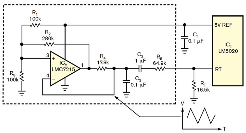

My customer is using the UCC28C44 in a high-voltage fly-back. For EMI purposes we need a simple circuit to dither the clock frequency. Do you have any suggestions?
On a related note, do we have any similar devices with this function built in?
