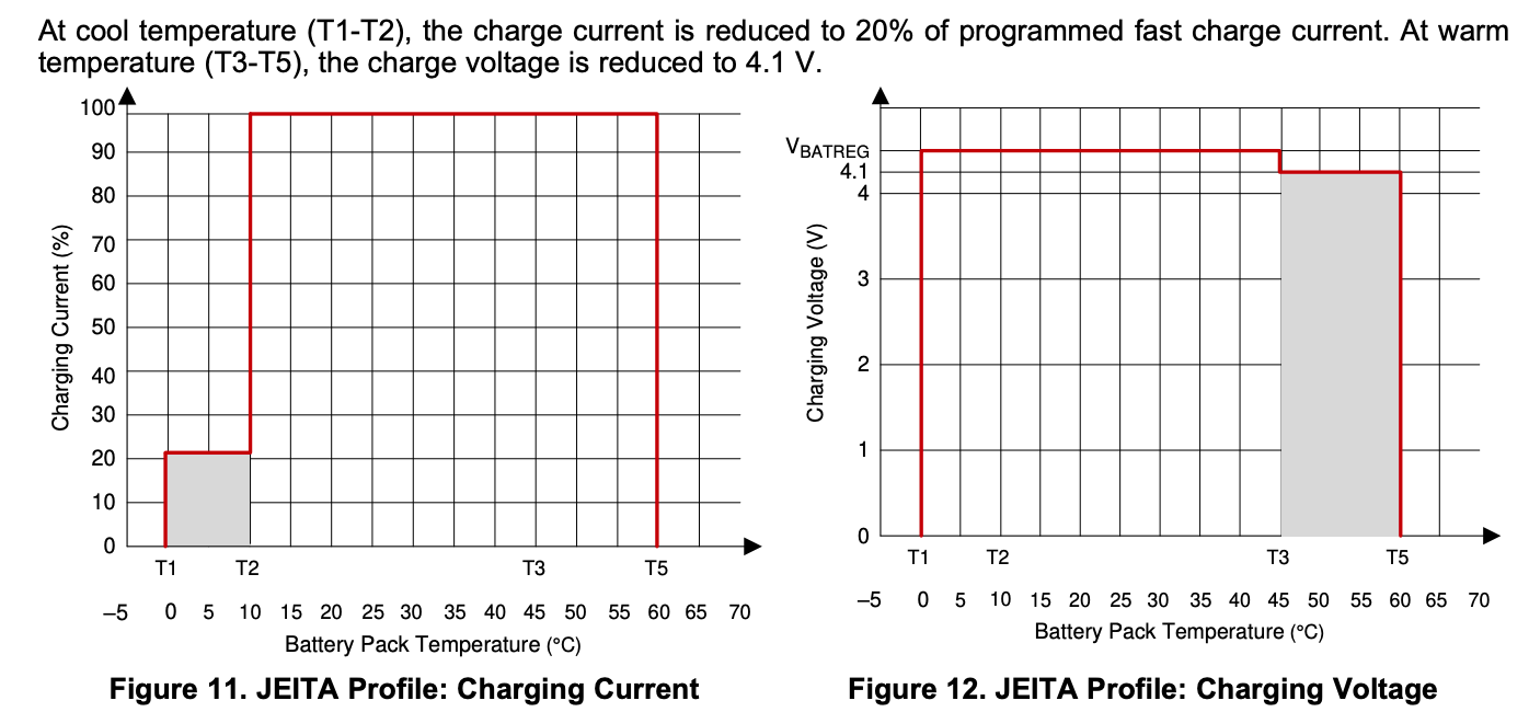

There are 2 conflicting values in the datasheet for the charge current when operating in the 0-10C region. According to the plot it is 20% of charge current. But in the electrical characteristics, it is charge current /2 (50%).
Which is correct?
Which is correct?
