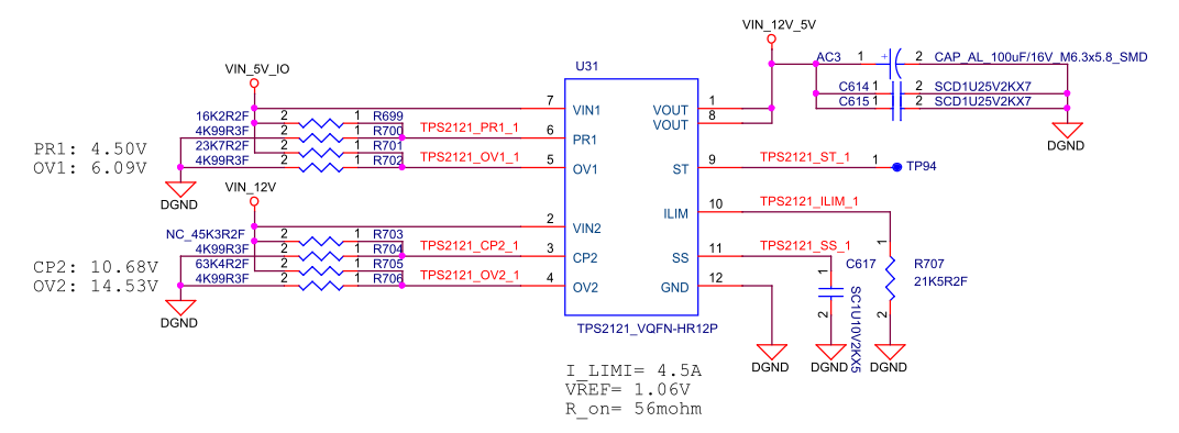

Hi Sirs,
Would you help recheck the TPS2121 schematic? The Vout is turn on/off repeat.

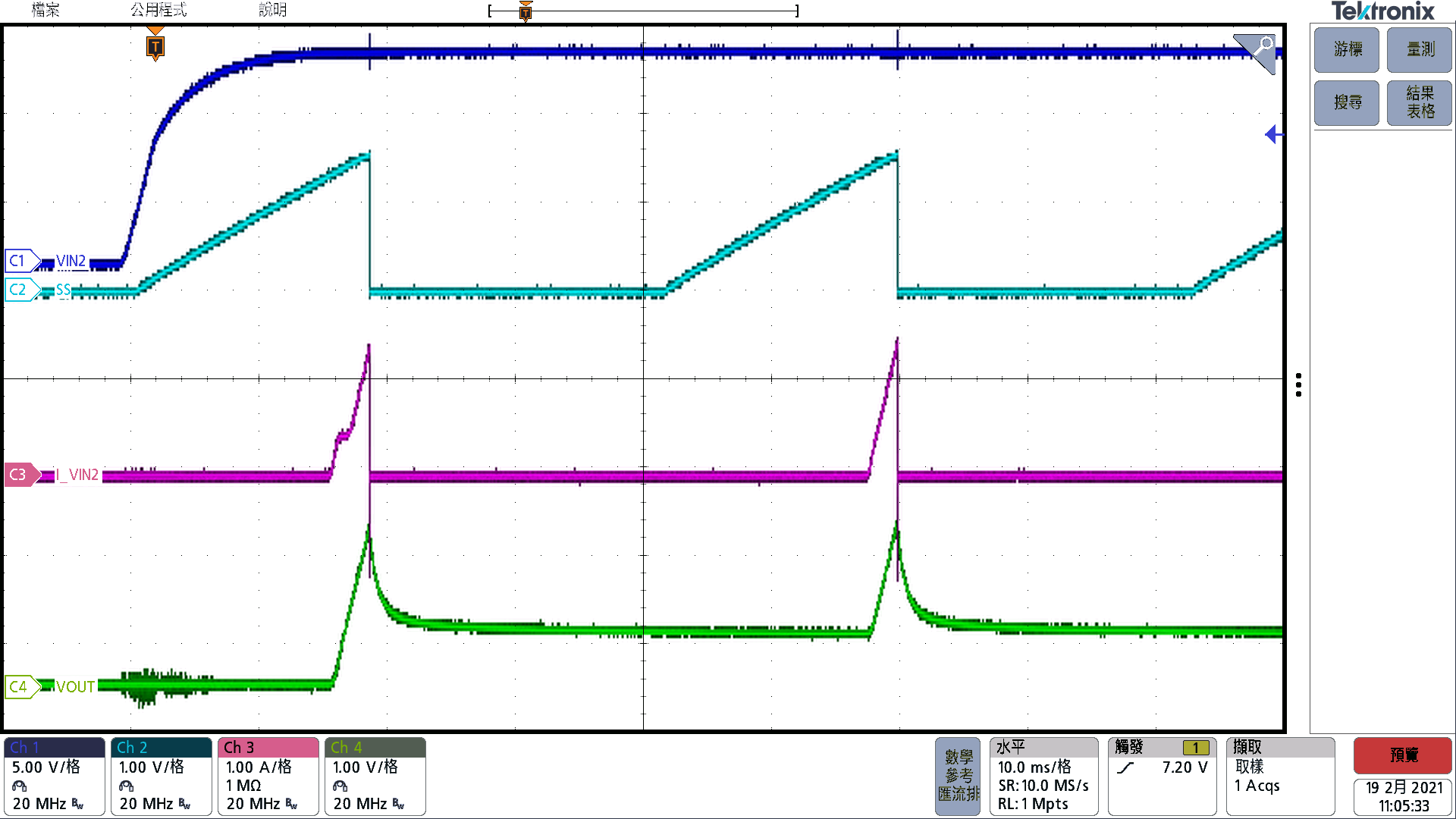

I measured the I_VIN2 (12V input current) is about 1.3A.
1, VIN1 is not valid (no connect) and VIN2 is vaild (connect to 12Vin)
2. Both PR1, CP2 are low.
3. Does the Vout off due to SS?
I want TPS2121 to function as the follows:
1. When IN2 voltage is valid only (IN1 is not valid), OUT voltage is IN2 any time.
2. When both IN1 and IN2 voltage are valid, OUT voltage is IN1 any time.
Thank you
