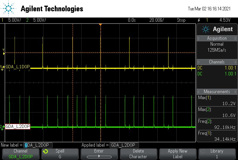

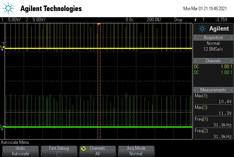

    6. Wave form enclosed
  • Hi Rajasekaran,
    Apologies but I am not able to tell much from this waveform (I assume these are the gate drive signals?). Please share the following waveforms.
    1.CSA
    2.CSB
    3.CAOA
    4.CAOB
    5.GDA
    6.GDB
    Ben Lough

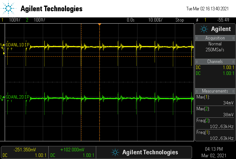

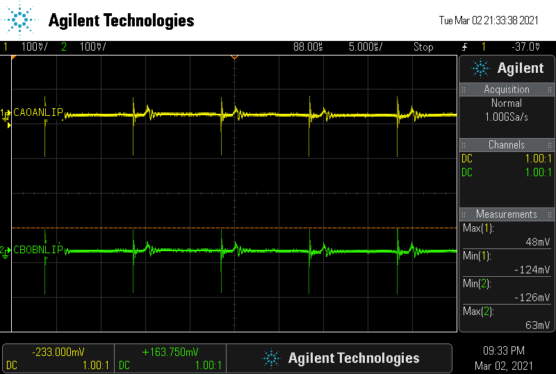

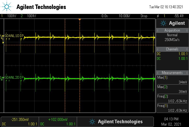

  • Hi Ben,
    Thanks for your support.

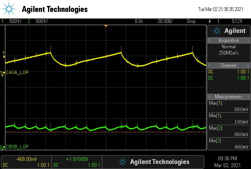

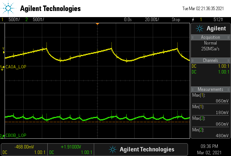

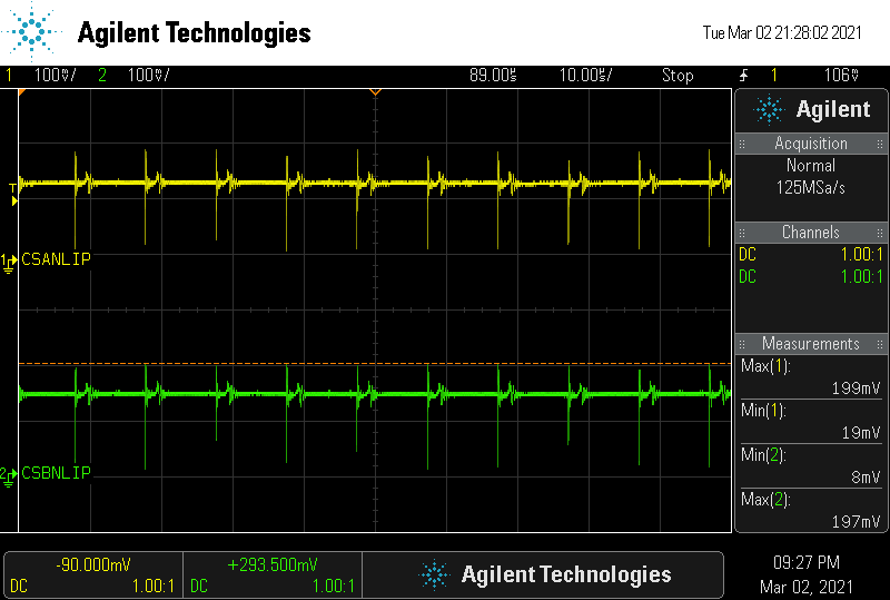

    CSA & CSB
  • NLIP - at No Load
    Lop - at Minimum Load
  • At No - Load
    At minimum Load

  • Hi Rajasekaran,
    Apologies for the delay. These waveforms look like they are of light load operation where the UCC28070 is entering zero power detection in some cases. Could you share a waveform of CSA and CSB when your output starts to droop like you mentioned previously?
    Ben Lough

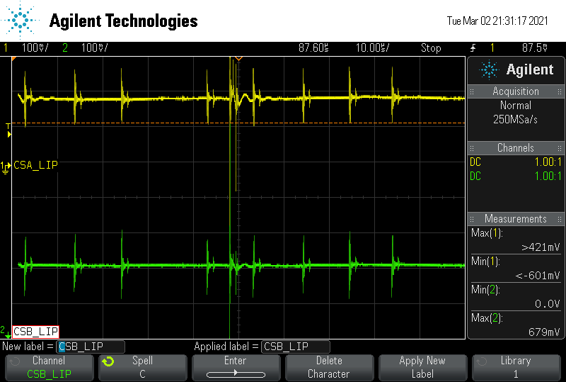

  • Hi Ben,
    Thanks for your patience.
    wave form enclosed for your reference.
    Thanks & Regards,
    Rajasekaran S

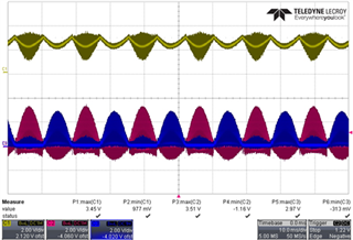

  • Hi Rajasekaran,
    Apologies for the delay. Let me share with you what the CSA and CSB waveforms are supposed to look like. Ch1=Rsynth, Ch2=CSB, Ch3=CSA. The CSA and CSB signals are supposed to be resemble the inductor current for each phase.
    From your waveform, it looks like at least in the time window shown in the scope capture the IC does not see the CSx signals hit the 3.3V peak current limit. So check the other signals in the feedback chain that might explain the droop.
    1. What is the voltage of VAO when the output droops? If the output voltage is drooping then the expectation is the VAO signal will increase to compensate the drop in output voltage. Is it hitting the 5V limit for the pin?
    2. Check CAOA and CAOB. These are the reference signals for the PWM comparators for each phase. Are the CAOA and CAOB voltages clos to the 6V ceiling or are they pulled low indicating the controller is detecting a fault?
    3. Check the shape of the IMO signal. Does it resemble a rectified sinusoid at 2x the line frequency? Or is it distorted?
    4. Check your duty cycle setting for DMAX. Is the controller running into the duty cycle limit at the heavier load?
    Ben Lough
