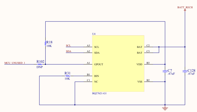

I am working on a bug for a customer where certain units fail to communicate via I2C with the BQ27621-G1 fuel gauge.  The host processor is an STM32F4 part (sorry, TI ).  Here is our circuit design:

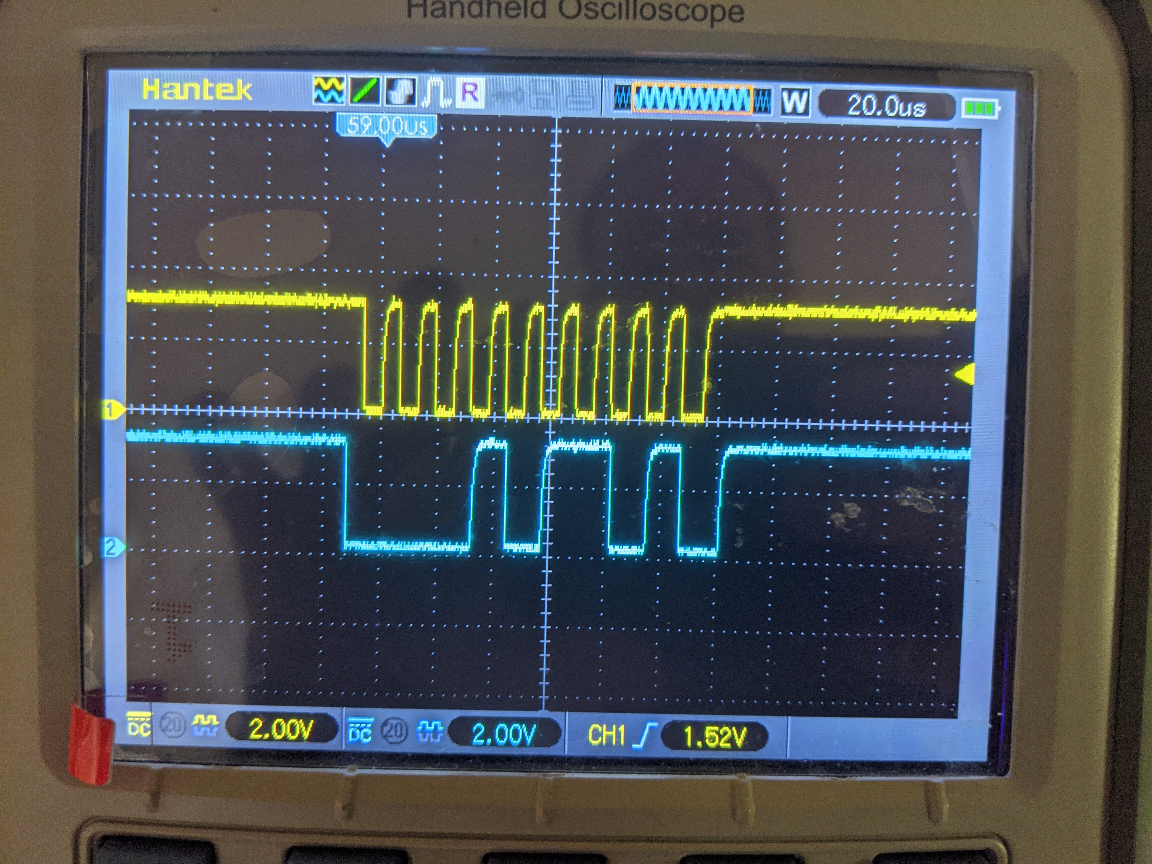

It has been quite difficult to characterize this mode.  The few times I have been able to duplicate it in a controlled way is by disconnecting the battery, waiting until any voltage in the circuit dissipates (particularly across VBAT), then reconnecting the battery.  Once the part is in this state, it NACKs any I2C communication until a power cycle, like so:

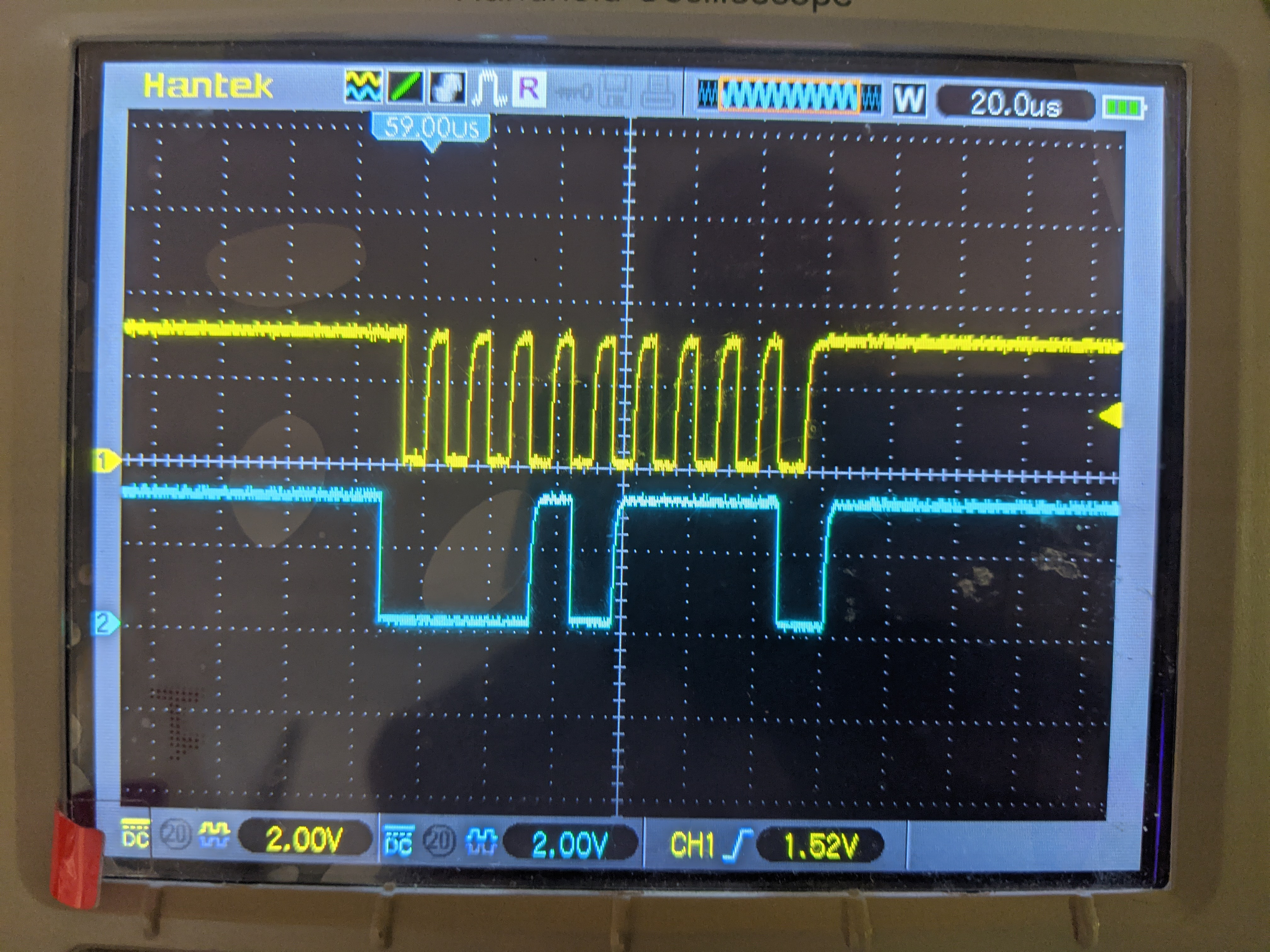

    The gauge could be entering a “fail-safe” mode during boot up. Does the gauge responds on (8-bit extended) 0x16 instead of 0xAA? Read one byte from register 0x00, I2C address 0x16. If it ACKs then the gauge entered ROM mode.

    I tried sending 0x16 and still get a NACK.  I assumed this was already shifted.  I attempted both a read and a write of 0x16.  Scope traces:

    The 8101 needs at least 2uF cap to startup reliably. Make sure that the derated value of your cap over voltage and temperature is still at least 2.2uF. TI recommends using a 4.7uF to account for derating.

    I'm not sure what the 8101 refers to I suspect the 8101 is the internal LDO.  I assume you are talking about the capacitance on the BAT input pin (across the LiOn battery terminals).  Elsewhere in the circuit, we have a 1 uF capacitor, which gets closer to the 2 uF you recommend.  However, this is some distance away from the fuel gauge.
    I will look into replacing our C128 (the cap right next to the fuel gauge) with a 4.7 uF capacitor and see if that helps.

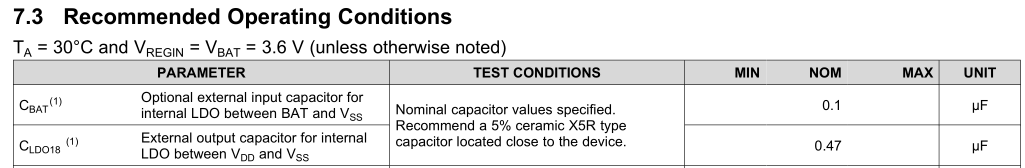

    Why is this information not in the datasheet?  The datasheet only calls for a 1.0 uF capacitor on the BAT line.  Also, the recommended operating conditions show a nominal 0.1 uF capacitor:
  • Looking more into the 8101 LDO - are you recommending to put a 4.7 uF capacitor on the LDO output?  That's what the datasheet for the 8101 recommends for stability.  This may make some good sense, since we are not using the 1.8V output for anything at all - it's only loaded by the output capacitor.

    Sorry for my delayed response. You are correct we are recommending a 4.7uF cap on the LDO output to help stabilize the "Hot-Plug" type of test. Was this able to resolve your issue?
