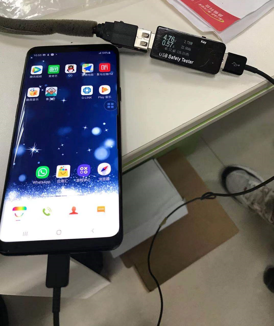

Hi team,
customer use TPS2546 for BC1.2. they found the current is lower than setting. In CDP mode, connect Samsung S9 smart phone, and use the original data cable. found the charge current only in the range of 0.3A to 0.57A. connect Iphone 5, the CDP current only 0.5A.
Can you give suggestions why the current can't reach up to high, any solutions. I have see the TPS2546 compatibility list , the CDP current of Iphone 5 can reach to 900mA, but in my customer only ~0.5A
below is customer test picture:
