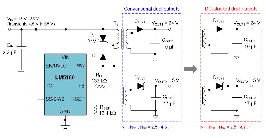

after reading the article (How to raise regulation performance with a stacked-output PSR flyback DC/DC converter
) from Mr.  , I have successfully implemented better regulation performance of VISO = 24 and 5V at LM5180 as shown below.
My question is "Is it possible to use DC-stack topology to implement positive VISO and negative VISO such as VISO = 24 and -5V at LM5180? "

    The easiest way to implement +24V and -5V outputs is with a common ground. See the application example in the LM5180 datasheet for +15V/-8V dual outputs. This corresponds with the LM5180 dual-output EVM, which is orderable on our website.

    Meanwhile, I've done +24V and -5V  successfully with "conventional dual output" by a hand-made transformer on LM5180 EVM.
    For next step, I am wondering to use "DC-stack dual output" to get the better regulation performance for +24V and -5V.
    But, I don't know how to handle common ground to get the negative output, -5V.
    So, Is it possible  to use "DC-stack dual output" to get +24V and -5V.?

    I think the conventional shared ground is the easiest way to do it - not sure if it's really possible to do a DC stacking. Note that the Excel quickstart file is available in the product folder to expedite design for a dual-output.

    Noted and thank you. I'd follow conventional shared GND for my next step.
