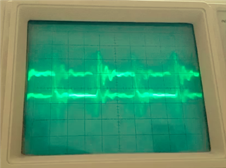

Stage 3;
Gate signal at the mosfet
initially, we observed the signal for few seconds
and then see that the signal is dropping down.
( division: y axis : 5V/ div, x axis : 1us/div)
During all the processes, we observed that the MOSFET driver IC is getting very hot in the span of few seconds.
We are using ucc27324 Mosfet driver as suggested in the 600 W design application.
could you show us the waveform on how the gate signal reads at the MOSFET gate? Is our waveform expected one?
We need help solving this issue.

    we did a few more testing as we were suspecting the gate drive transformers.
    We probed the signals at pin no.3 and 4 of tgate1 ( figure in the previous post)
    We changed the gate resistance: r16, r17,r18,r19 from 3.01 ohm to 2.34kohm and observed that the MOSFET driver is not getting unusually hot ( as mentioned in the previous post).
    However, we measured the gate signals at the ( gate A+, gate A-), (gate b+, gate b-)( from the schematic )and found that
    gate A+, gate A- measures the following
    gate B+, gate B- measures the following
    we see that the signals are not complimentary.
    are the scoped waveforms expected? what can be the reason that both the waveforms are not identical and not complementary?

    Channel 1: Out C measured at the MOSFET
    channel 2: out C measured at the controller.
    (their waveforms are measured when no input the converter is connected)
    Are these expected waveforms?

    We were measuring the gate drive waveform at input AC voltage 70 V( rectified DC 100V) ( with the transformer on the board)
    We observed a lot of distortions on the gate of the Fets. We were driving the gate with 13V (from a dc Source)
    ( we measured FET A gate voltage)
    At 80 V AC ( 113V DC) we observed the following Waveform
    and the diodes D1 and D2 got damaged.
    How can we reduce the distortions on the gate of the fets to get a clean gate drive signal?

    The gate drive waveforms that you are too noisy.  You may want to revisit the layout around the gate drivers to make sure that the layout is properly done.  Both the UCC28950 and the gate driver should give you recommendations on how to do the layout.   There is also very good section in an application note for operational amplifiers titled "Op Amps for Everyone" that has a really good section on layout.  The following link will bring you to this application note and the layout information is in chapter 17.
