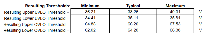

On LM5069_Design_Calculator_REV_C excel file, we can see the following resulting Thresholds:
I understand how to calculate Lower UVLO Threshold.  However, I want to know how to calculate Upper UVLO Threshold.  Could you please advise us?

    The design calculator uses calculations discussed in Section "9.2.1.2.6 Set Undervoltage and Overvoltage Threshold" of the LM5069 datasheet. Please refer and let me know if you still have questions.
    Thanks!
