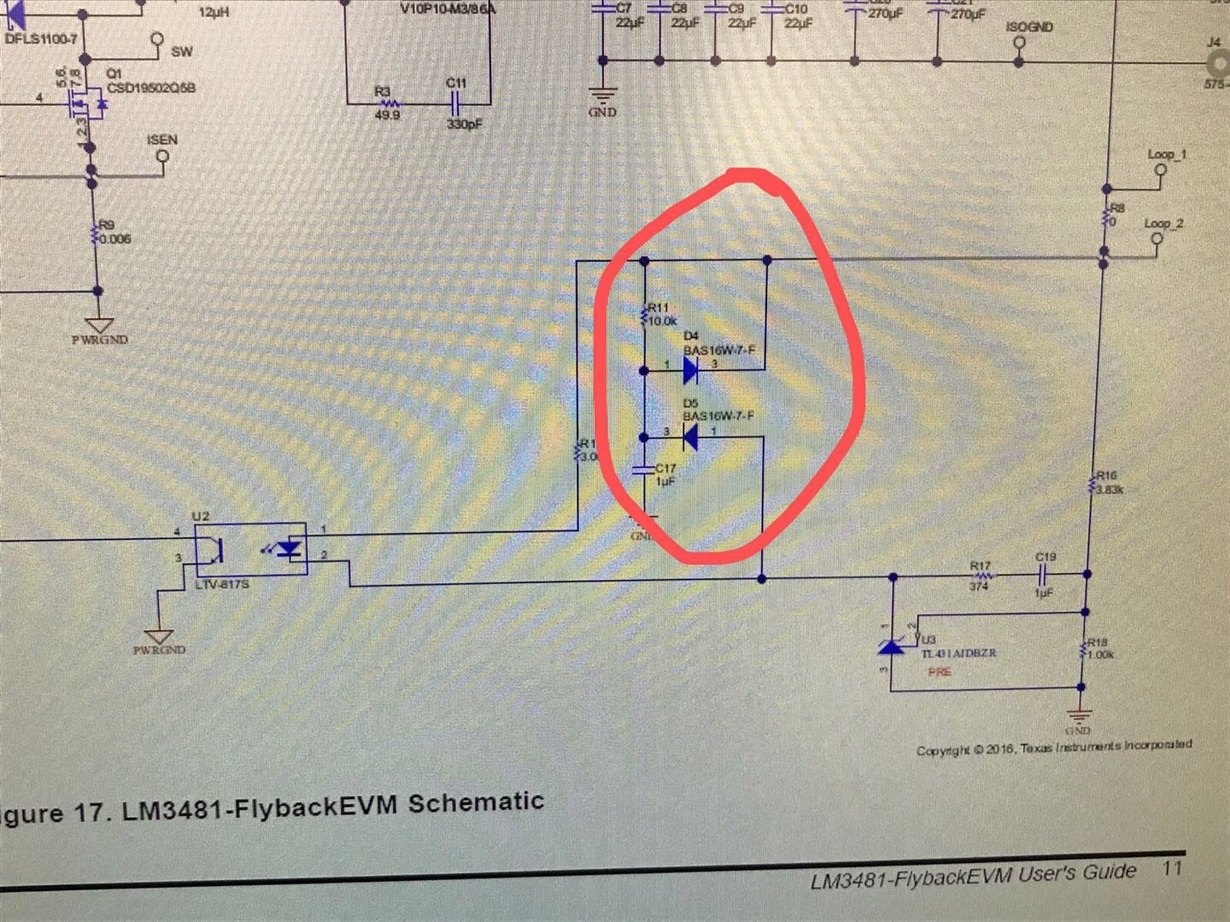

Could you help to comments why we add D4 D5 on feedback net of LM3481?
Thanks.

Thanks for reaching out. When the FB pin of the LM3481 is grounded there is no soft-start functionality. For a flyback design this can be implemented on the secondary side by soft-starting the voltage reference and this is what you circled on the schematic of the EVM. The C and the R are defining the time constant of this soft start.
