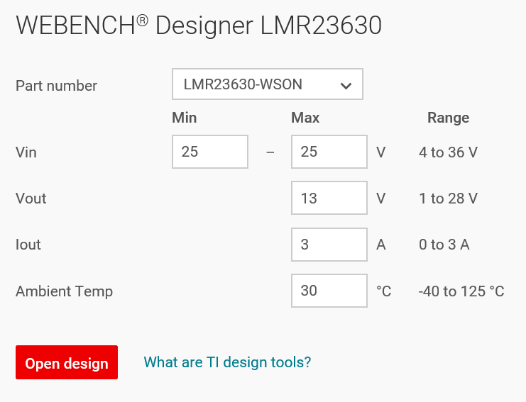

I am doing WEBENCH on the LMR23630 device.
The device conditions are shown below.

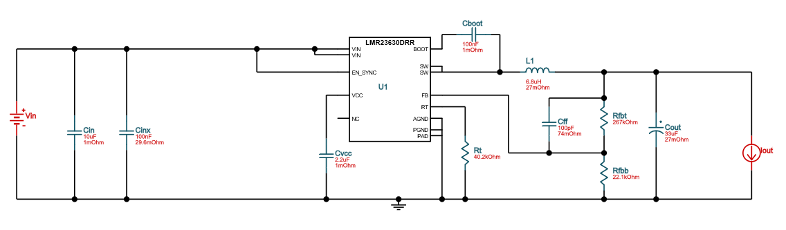

Then design the User Preferred Frequency at 1MHz.
At this time, Rt is set to 40.2 kΩ.
However, the value will be different if you calculate using the formula in the data sheet.
Is the Rt output result of WEBENCH wrong?
