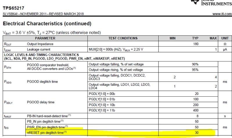

Can you let us know the max NRESET pin deglitch time for the TPS65217?

    No, we cannot confirm the maximum deglitch time for any of these input signals. They are typical values which are guaranteed by design but cannot be tested in final production.
    The majority of timing parameters in the ms range cannot be tested in production because the test time would simply be too long. These input are intended to be slow moving signals (high or low for seconds at a time), and the typical deglitch times are standard values used to filter out glitches on an input that may be controlled by a tactile switch or push-button.
