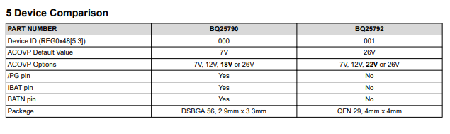

My customer is working with BQ25790. While checking another component they found a comparison between BQ25790 & BQ25792 on BQ25792 datasheet page 3.
For BQ25790 ACOVP =7V default value. DO we have this limitation when we use back-to-back MOSFETs for VBUS & let the BQ25790 drives MOSFET gates? If they don't use this configuration & they connect 12VDC on VBUS & VAC1 & VAC2, is this configuration correct even though that it is the most common way to use the device?
