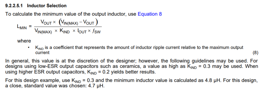

I am working on a design using a TPS54531.  the input voltage is 12V the output requirement is 6V at 700mA.  The Lmin calculated is 25uH.  So I decided to go with a 33uH inductor but when I calculate the Iripple its 200mA.  Is that what I'll actually see on the output?  I calculated again using 330uH and get 20mA, better.  I go into Webench and put in my values, it likes the 33uH but 330uH destroyus the phase margin so it won't work.  If the Iripple is an output result I need to drop it significantly but stay within the phase margin!  So explain the iripple to me please.
