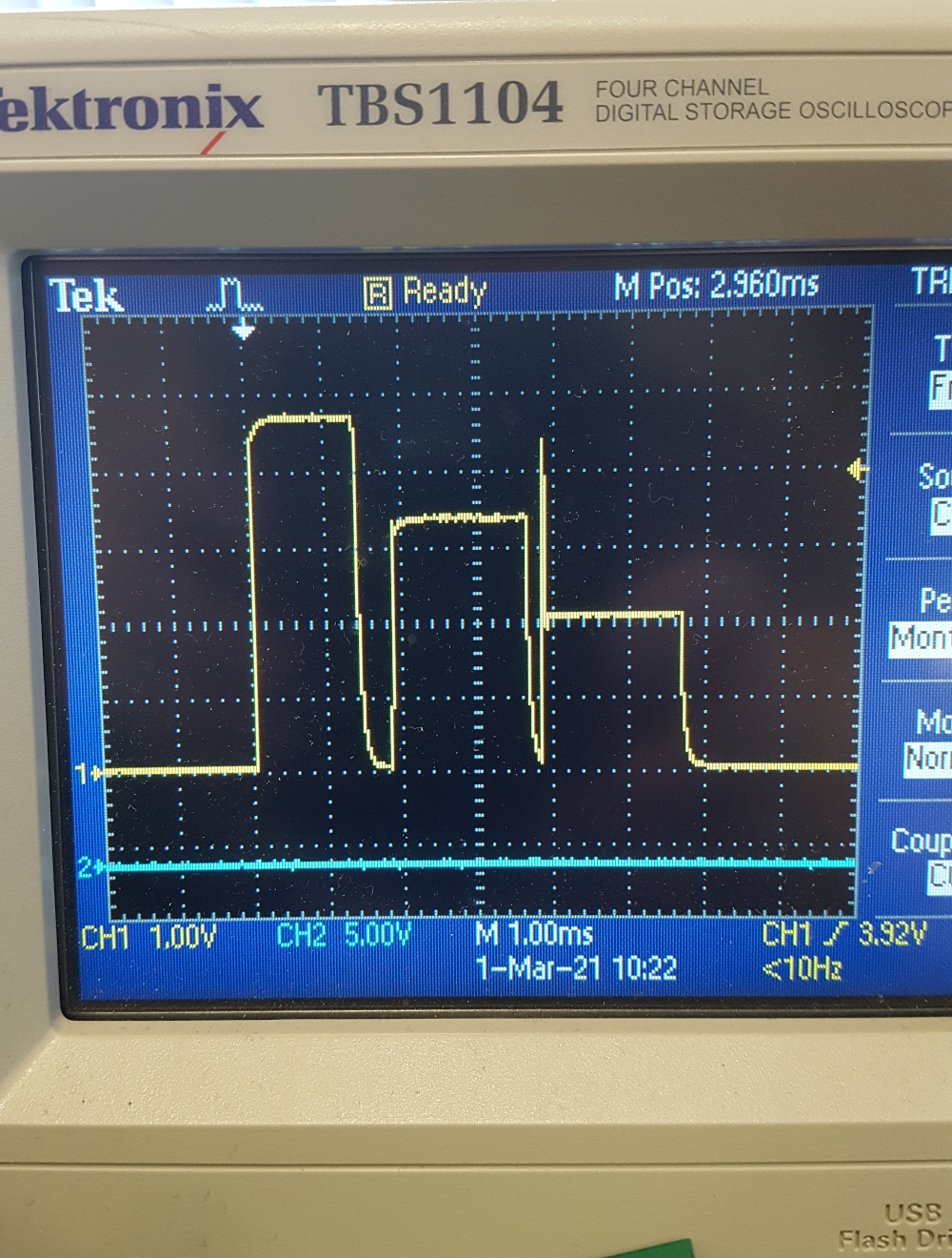

    After VSTOR>2.0V, if you take an oscilloscope plot of VRDIV similar to figure 28 on page 26, the first pulse should be VSTOR, the second 2/3 of VBAT_OV and the third (not shown in the datasheet plot) is VOUT.  Are those values correct?  If not, then parasitic solder flux resistors may be changing the threshold values as explained in datasheet section 10 page 34.

    You can see on the oscillogram of VRDIV that all pulses are correct. What do you thing of the spike present at the start of the third pulse ?

    Based on your plot, VSTOR is rising to 4.7V but is set to 5.1V [3.4V/(2/3)] but your VBAT_OK_HYST voltage is 4.8V, correct?  If so, then VBAT_OK will not go high.
    To clarify, even if you use a bench power supply instead of solar panel at VIN_DC, VSTOR does not rise to your desired output voltage?
