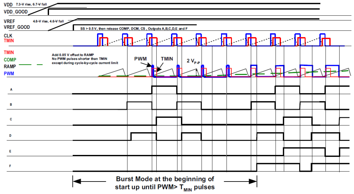

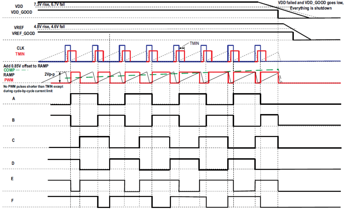

Refer to Figure 1 & 2 and TMIN definition from the datasheet, TMIN setting does not affect the OUTA-OUTE and OUTB-OUTF delays. Is it correct? Please advise.

Gary,
you are right.
TMIN is the burst mode threshold, in burst mode OUTE/OUTF are disabled, so your comment is right.
