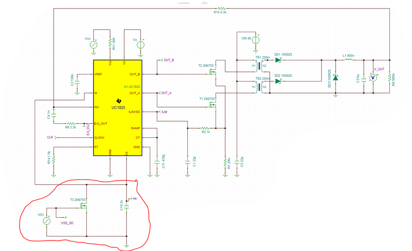

    There is an internal 9uA constant current source pushing current out of the SS pin. The expectation is that the load on the SS pin is a fixed capacitor that gets charged up to VREF (5V). With SS connected to NI, you are relying on a current into a capacitor as the reference into the error amp (NI). When the OV occurs, NI/SS are pulled LOW and INV is heading LOW as VOUT capacitors are discharging. It could be that the timing of NI vs INV both going LOW is an issue? Then there is the scenario that perhaps the output capacitors have no fully discharged but the OV condition is removed and the restart happens into a prebiased load.

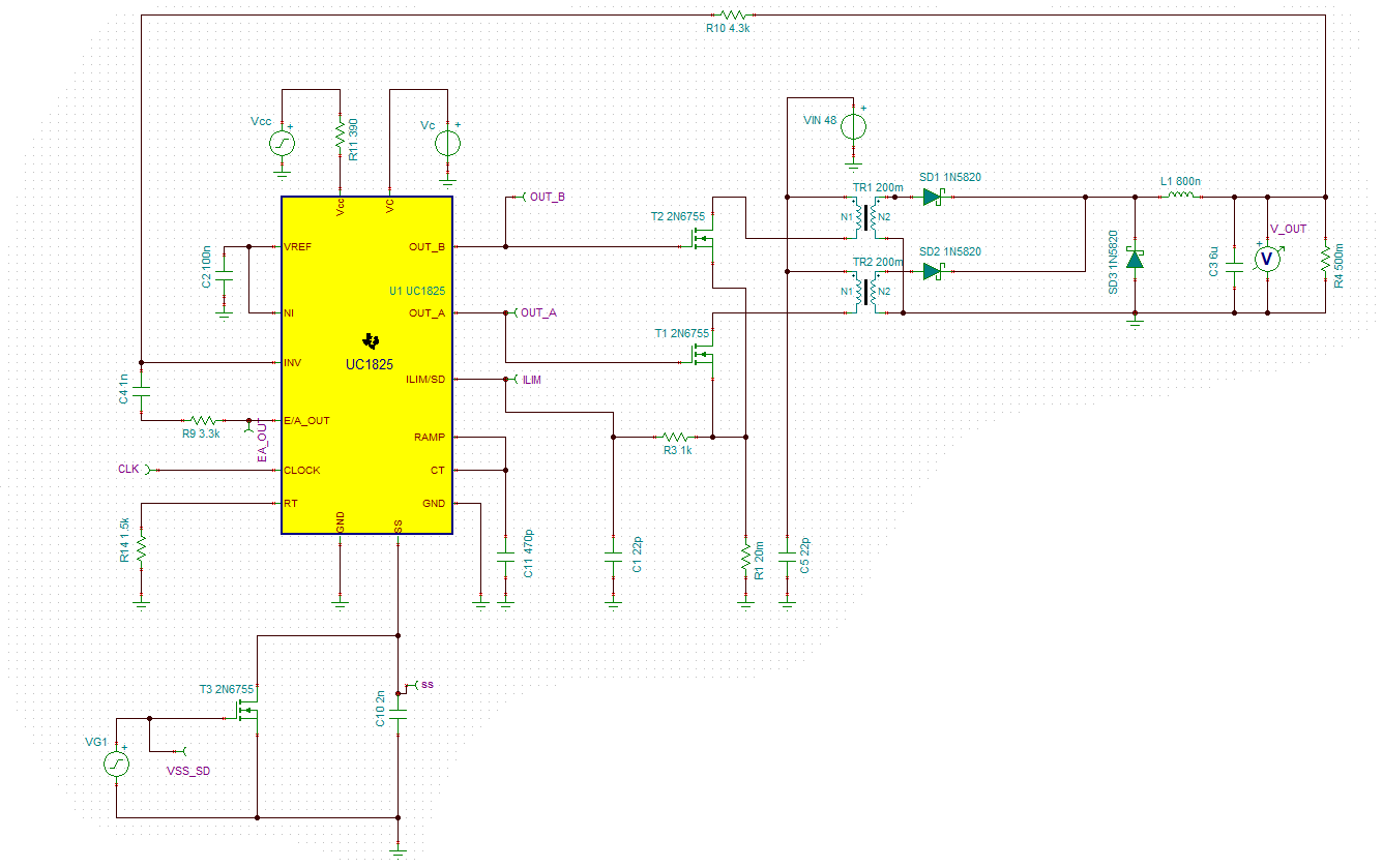

    I added this pulldown to the TINA sim you can download from the UC1825 product folder. I allowed the sim to run for 4ms and then apply the gate signal at 2ms to simulate the OV fault:

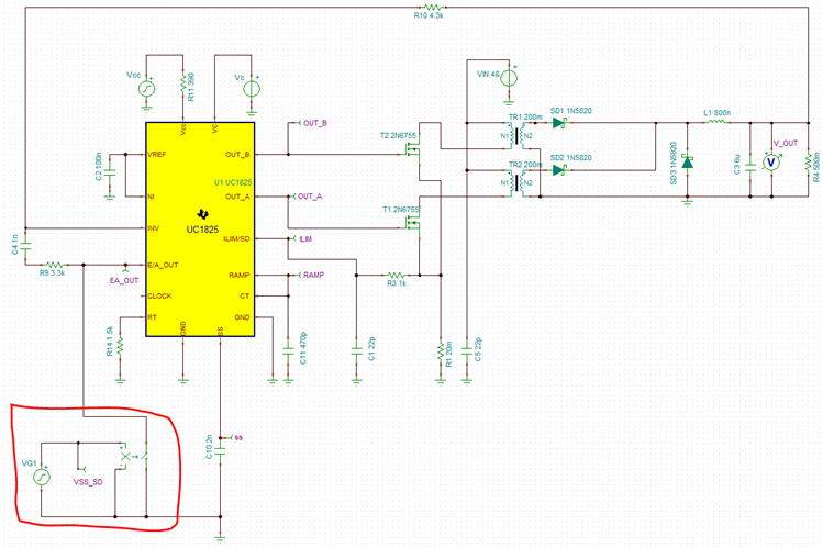

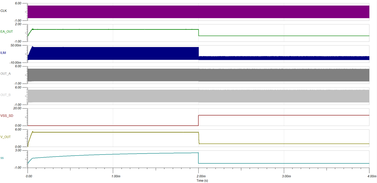

    At 2 ms, SS gets pulled LOW, but OUT_A/OUT_B remain switching, which keeps VOUT>0V and therefore keeps INV>0V

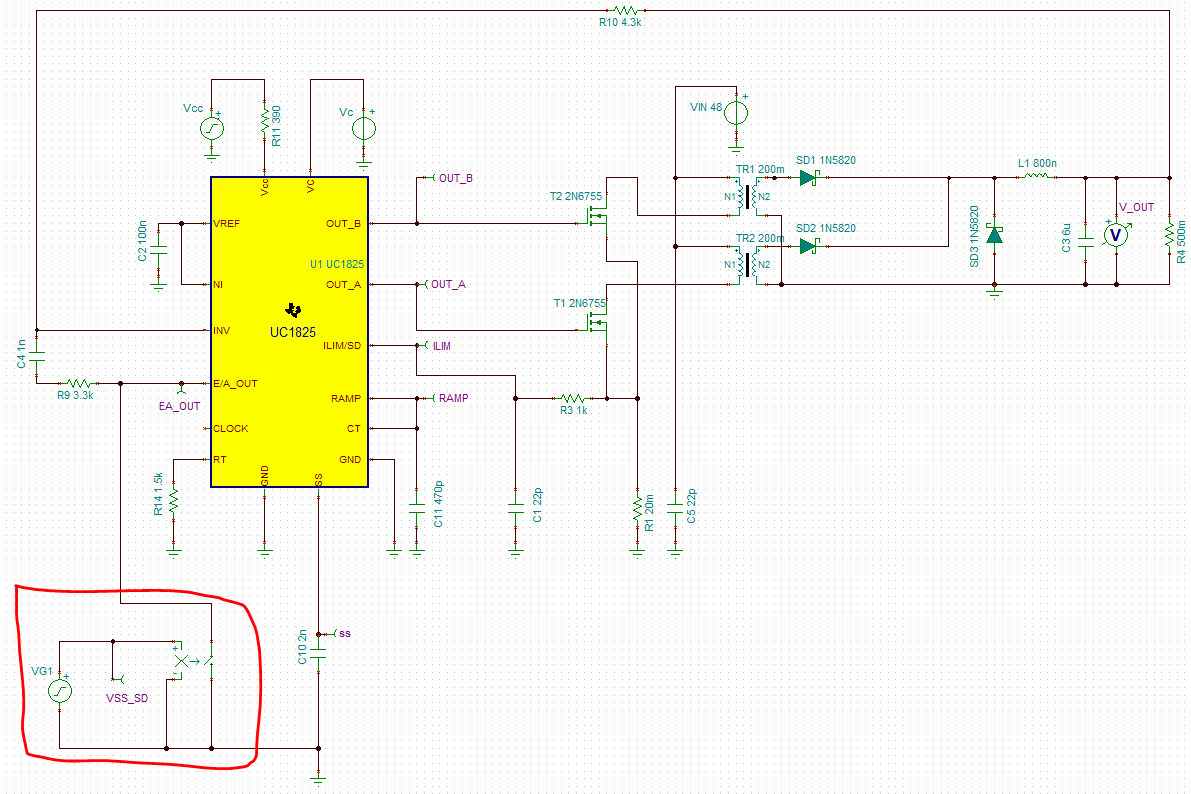

    Disconnect SS from NI and connect NI to VREF:
    Similar to previous sim, at 2 ms, SS gets pulled LOW but OUT_A/OUT_B remain switching, same result so it seems this behavior is independent of whether SS or VREF serves as the NI reference to the error amp. Pulling SS LOW is not disabling OUTA/OUTB.

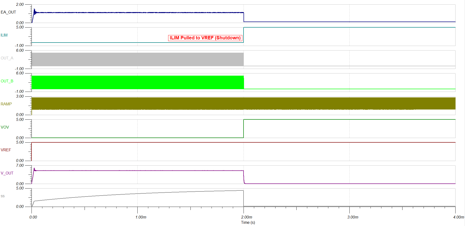

    Pulling SS/NI or EAOUT LOW will not disable the UC1825. The best way to disable the controller is pulling ILIM/SD HIGH. I used a voltage controlled behavioral switch to pull ILIM to VREF during a simulated OV fault. In a power converter, this would assume VCC bias is available to the UC1825, otherwise the controller is stuck in continuously trying to restart from the line voltage while whatever event/failure caused the OV fault may still be present. Below is how it works when pulling COMP LOW (the wrong way to disable and similar to pulling SS/NI LOW) vs pulling ILIM/SD HIGH:

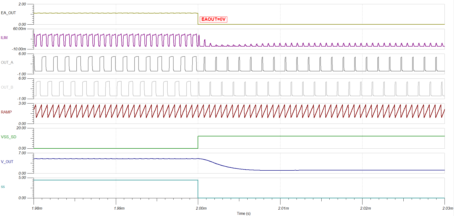

    Pulling EAOUT LOW independent of SS:
    COMP pulled low, SS goes LOW and controller maintains a minimum OUTA/OUTB on-time which would be the beginning of a soft start cycle, if COMP were released.

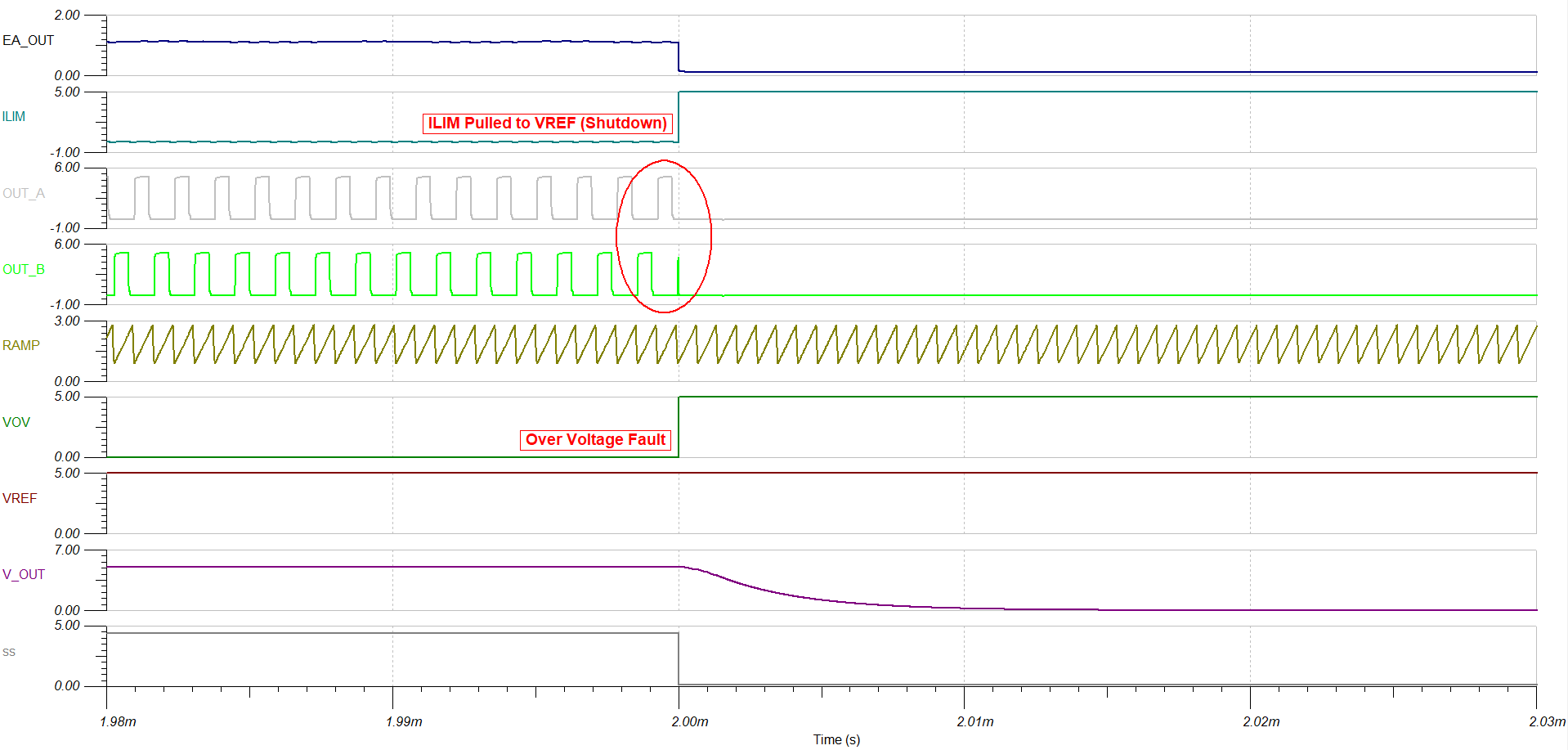

    Pulling ILIM/SD HIGH to VREF during OV fault:
    Zoom in view:
