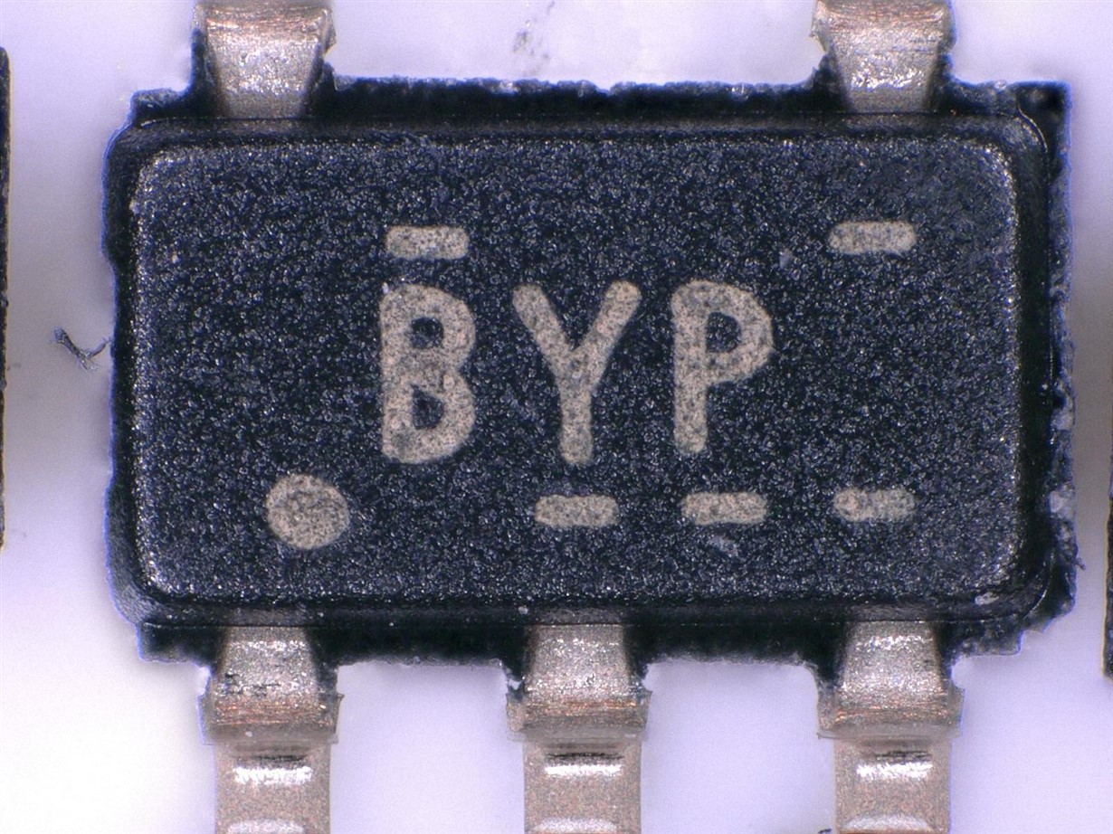

Part Number: TPS62260
What's the significance of the dashes above/below the "BYP" on the TPS62260DDCR device markings?

Hi Mark,
I will check what signifies the "bar" above and below the device marking. I hope to get back to you tomorrow.
Excel
Hi Mark,
The "bar" on the upper portion of the body markings signifies the binary year code, while below the markings indicate the binary month code.
