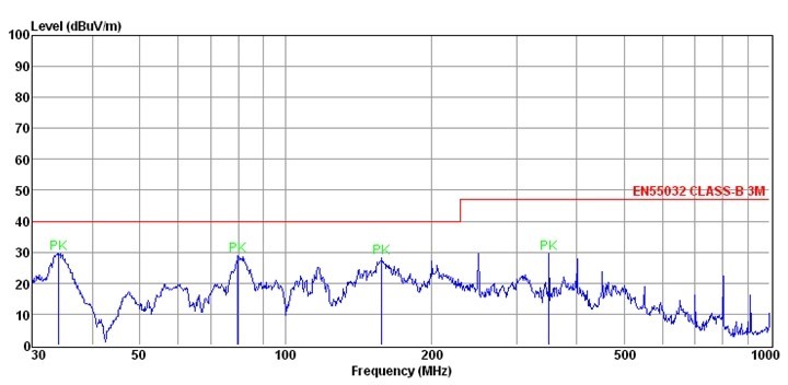

Now using TI's power supply scheme LM5022+TI's PSE controller scheme TPS23861 design of the 4-port PSE switch, CE (conduction) and Re (radiation) test results are as follows, among which CE exceeds the index more, we hope TI can provide relevant test data and improvement suggestions.The transformer is 25SEFD-0901DJNL(PN:YEL731R009).

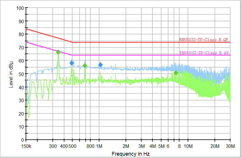

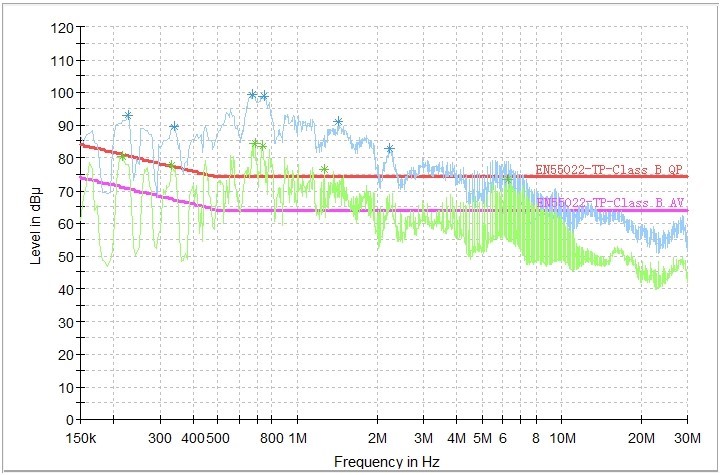

CE: PSE power supply works, and PSE port has data, other network port CE curve
CE: PSE power supply works, but PSE port has no data when other ports have CE curves

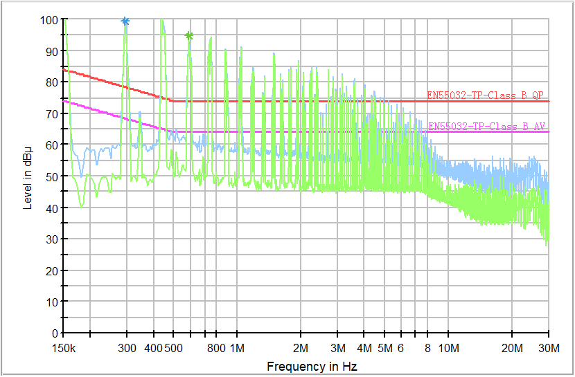

RE

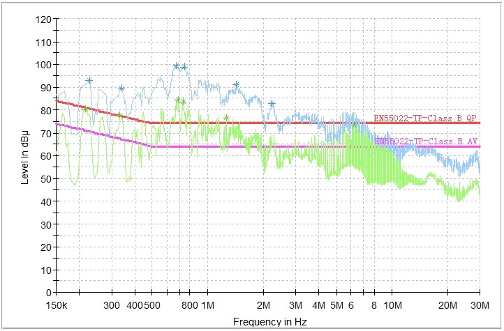

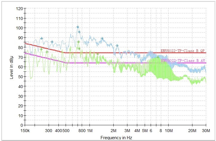

  • I changed RT back to113KΩ to make the frequecy meet to 150KHz,then I shielded  the transformer by copper foil. The results of the RJ45s without PSE changed good, but the RJ45 with PSE was still bad. QP and AV were up to 100 dBu, and the frequency of the higher points were integer times of 150KHz, that meeting the switching frequency of LM5022.
    I also added a common mode choke(TDK:ACM7060-701-2PL) at the PSE port, then palced a 1nF cap befor and behind the common mode choke. But that seemed useless.
    RJ45 with PSE + Transformer Shielded.
    RJ45 without PSE + Transformer Shielded.

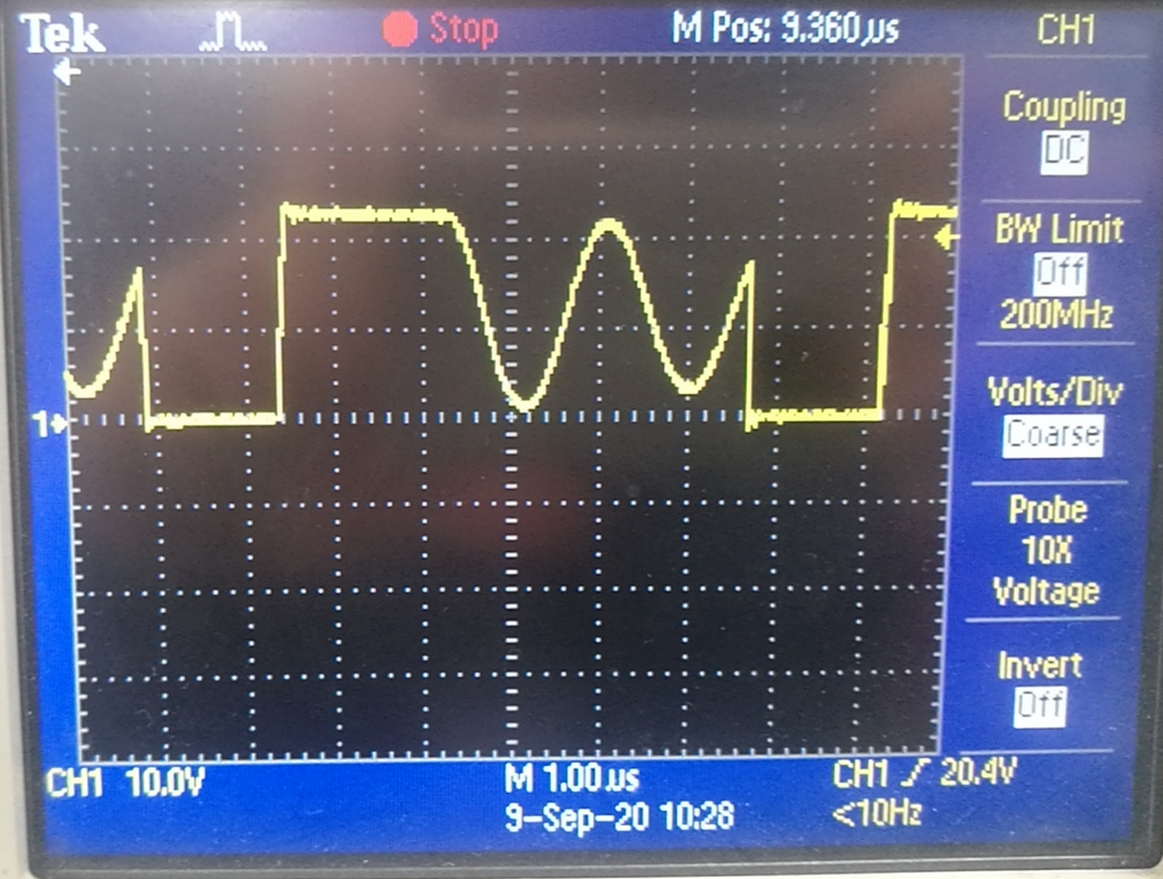

    Waveform at  Pin7 of Transformer:
    Waveform at  Pin3/4 of Transformer:
