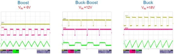

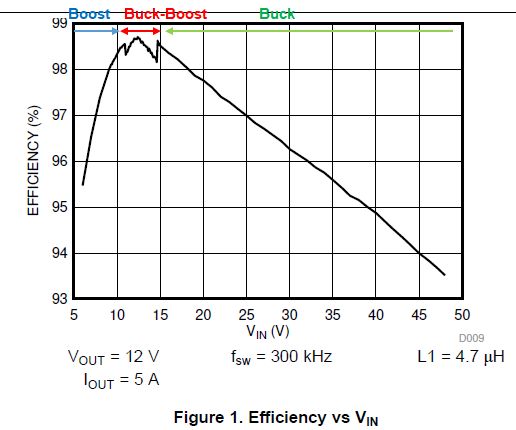

Hello support team,
Customer inquires LM5176 behavior at buck-boost mode. In buck-boost mode, both power stages do switching with half frequency than buck or boost operation. Why does LM5176 set half frequency at buck-boost mode? Does this mean max duty behavior on both buck and boost mode?
