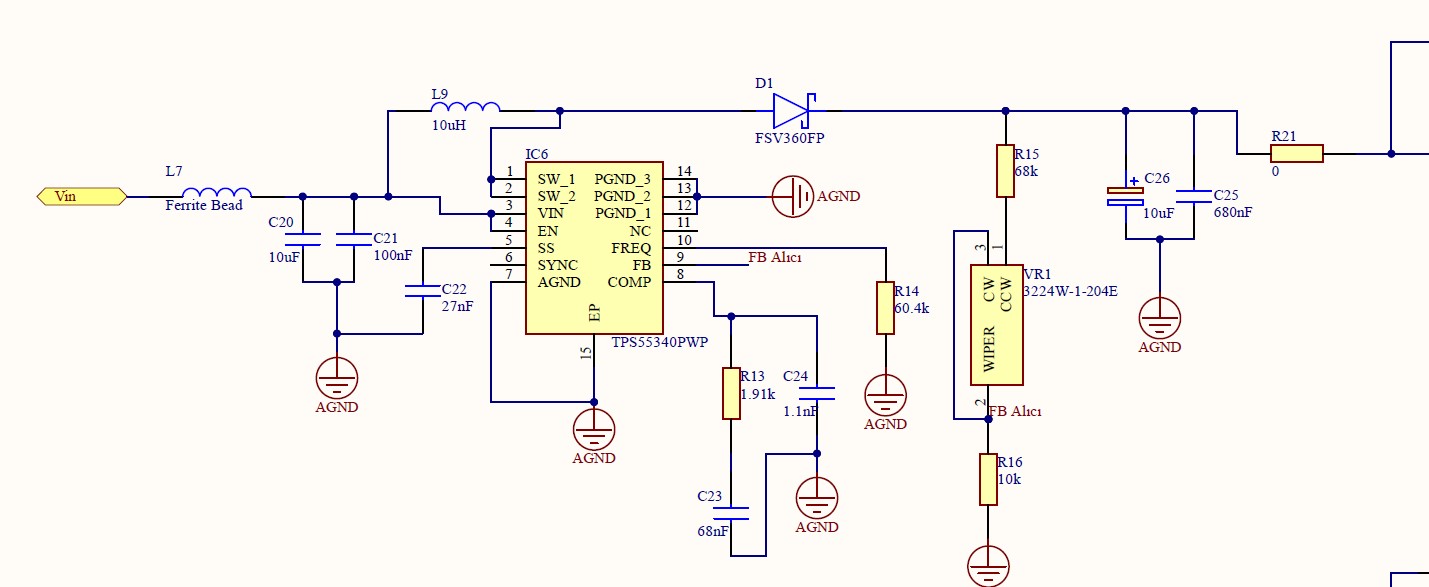

We are using TPS55340 for boost converter. During the test, it has very high ripple for our design. Our schematic is shown as below, and we designed TPS55340 using webench design. Our input voltage is 12V, and we want the output between 10-35V. In our design our ripple is around 100mV with 750kHz frequency.
We are demanding ultra low ripple boost converter. The output ripple does not exceed 100mA. Also, the operating current is around 30mA. Can you suggest as much as minimum voltage ripple boost converter IC?
Is there any minimum number of capacitor on the output of the boost converter for low ripple? When we use more parallel capacitor on the output, what effect can be occur?
If we should use more capacitor to the output, should it same value or not?

    Would you please re-attach your schematic? It got lost somehow.
    Please check if you are seeing a behavior as in Figure 22 of the datasheet, then the load is too low for entering continuous conduction mode for higher efficiency at light load. This increases efficiency, but increases ripple as well.
    If you are ok with a lower efficiency for getting a lower ripple, you should select a converter that permanently switches independent of the load, e.g. TPS61175.
    BTW, you will not get 10V on the output with a 12V input on a boost converter. Boost converter always regulate the output to a higher voltage. If you need to regulate up and down, I recommend to have a look at buck boost converters like TPS55288.

  • Hi
    is the C26 aluminum capacitor or ceramic capacitor? if former, please change it to ceramic cap and add more ceramic capacitor

  • Hi Ozancan,
    let's focus to optimize the performance of TPS55340 firstly. the 100mV ripple is not very hard.
    the lowest ripple device could be TPS61378-Q1 if the output voltage is not very high

  • Hi Ozancan
    is the maximum voltage 35V? what is the minimum output current? do you still need low ripple at the minimum loading?
    if the ripple is very critical, you can consider to add a LDO between the boost and the loading.

  • Hi Ozancan,
    the requirement is not easy to meet. the TPS61170 should be the closest solution, but I can't sure if it is doable because the VIN, VOUT and IOUT condition greatly impact the ripple performance, so I would suggest you to apply EVM to evaluation.
    another solution is the TPS61391, which integrate the boost and a filter circuit, but the input voltage should be lower than 5.5V, and output current can't be such large.
    about the LDO, I refer to the a solution such as TPS7B4253-Q1. the input of the LDO is the output of the boost and the output of the LDO is the loading.
