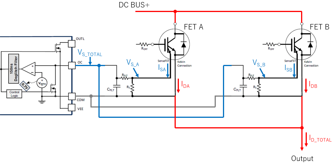

I am considering using UCC21732 to drive two FETs connected in parallel.
If each FET has a Sense-FET pin, would you tell me the recommended way to connect it to the OC pin of UCC21732.
I would like to consider a circuit that can be detected by the OC pin regardless of whether either of the FET is overcurrent alone or both FETs are overcurrent.
In this condition, in case of the circuit model in Figure 9-8 in the datasheet SLUSD77A, I can't connect 2 Sense-FET pin parallelly in point of after Rflt resistor, is it correct ?
Thanks and Best Regards.

    Thank you very much for your quick answer. And thanks also for many solutions you gave me.
    Option 2 or option 3 is good for me.
    In case of option 2, let me confirm my theory is correct or not please.
    Regarding the attached picture, can SenseFET be considered as a current source ?
    If yes, and if I want to set OC trigger for 100A total (50A for each FET), I can select 700 ohm for each Rs resistor. Is it correct ?
    Each FET's Ioc_th = (Vocth / Rs) * N = (0.7 V / 700 ohm) x 50000 = 50A, when N = 50000
    Total Ioc_th = 50A x 2 = 100A
    In this case, if unbalance current through (ex. Ida = 25A, Idb = 75A) was occurred, Vs_total can be calculated as following ? And it can be triggered OC. Is it correct ?
    Vs_total = (Vs_a + Vs_b) / 2 = (0.35 V + 1.05 V) / 2 = 0.7V
    Vs_a = (25 A x 700 ohm) / 50000 = 0.35 V
    Vs_b = (75 A x 700 ohm) / 50000 = 1.05 V
    And if another unbalance current through (ex. Ida = 25A, Idb = 50A) was occurred, Vs_total is not enough to trigger OC. Correct ?
    Vs_total = (Vs_a + Vs_b) / 2 = (0.35 V + 0.7 V) / 2 = 0.525V
    Vs_b = (50 A x 700 ohm) / 50000 = 0.7 V
    Roughly. Its more of a current mirror as its drain current is NOT totally independent against the source voltage shift.
    Correct on both, roughly. Note that if there is such a vast different in currents, some current will pass thru 2xRFLT to the other sense voltage node.
    With this implementation, if the SUM of the currents I_SA and I_SB is 100A or greater it will trip OC, or said another way, the average current in each FET should be <50A or it will trip OC. One could be 10A one could be 90. One could be 0 the other be 100A. The way you have implemented is actually eliminating some issues which i mentioned in my initial response.
    I would remove one CFLT and keep both RFLT (this is a requirement to average the voltage VSA and VSB).
    CFLT and RFLT placed close to OC pin.
    Note that such a vast different in drain current is a corner case and means one of the FET is broken. The advantage of your implementation is that if later you prefer to just take sense current from only one fet, you only need to remove a couple resistors from the board without changing any of the other passives values.
    Please let me know if any additional questions.
    Best
    Dimitri
  • Thank you for your prompt answer.
    Understood.
    I think I can start the circuit design.
    Thanks again for your excellent support!
    I will proceed this thread to resolved stage.
