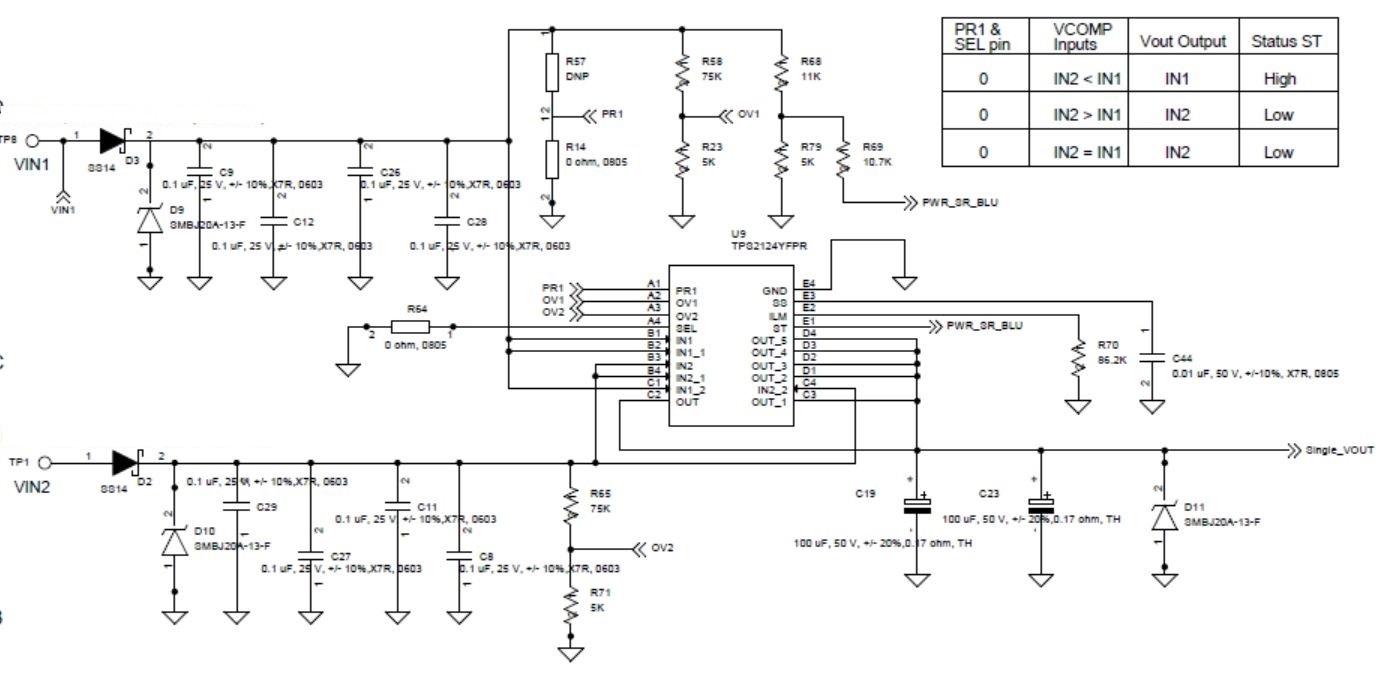

    PR1 & SEL pins are grounded. I can share the waveforms on 8th March, as you mentioned. please find attached the schematic of the TPS2120. Output of this TPS2120 is given to the LDO input of TPS7B6750Q with input electrolytic cap placed with value 47uF,50V,20%,SMD.

    Is it possible for you to retest this but to add some sort of priority in place? My suggestion is to set the system to prioritize IN1 at 11V and above. I am wondering if the situation that I described in my last post is causing some of the devices to bounce between the inputs as they get loaded an unloaded since they are the exact same voltage.
    I also noticed that your SS cap is only 10nF and your ILIM is set to under 1.5A  but you have a large output capacitance of 200uF. Please make sure that the inrush current caused by these output capacitors is not causing the device to hit its current limit. An easy test for this is to switch out the SS cap for a larger value, lets say 100nF or even 1uF.

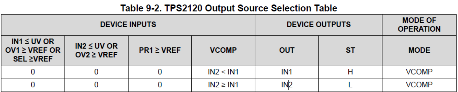

    As per mentioned in the first post, we are using in the mode "Highest Voltage Operation (VCOMP)"  where the device automatically selects the highest voltage supply to power the output as per the datasheet under the section Figure 10-15, as per this PR1 & SEL to be set ground. the same is been implemented in our circuit. also as in the Table 9-2. TPS2120 Output Source Selection Table below, when both IN1 & IN2 is with equal voltage then OUT should be IN2 with ST pin low, this is not happening as in table
    I have also shared the schematic in the second post for your reference, where we have grounded PR1 & SEL to ground. kindly check & suggest some solution.

    As per in the datasheet of TPS2120, it has mentioned that when both input has equal voltage OUT will be IN2 & ST will be low. as in below image. i have also checked by reducing the IN1 voltage & increasing the IN2 voltage & vice versa still the ST line is high fallowing the IN1. moreover this is also working fine in other 3 no's of boards when both inputs are at 12V. as i have informed in first post, only other 4 no's of boards have issue.

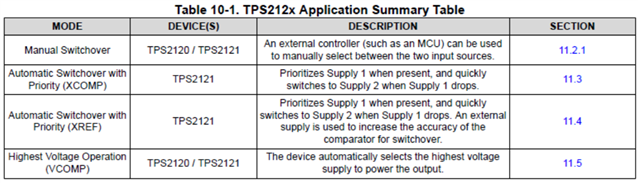

    Also TPS2120 does not have Automatic switchover with Priority as in TPS2121. hence PR1 & SEL is Grounded. find attached the image as in datasheet application.

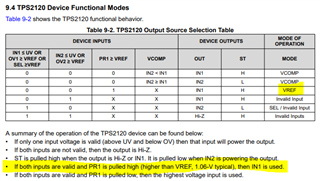

    TPS2120 does have priority with auto switchover. It is called VREF mode. In Table 9-2, it is the third row.
    You can use a resistor divider on VIN1 to set this. The device will run in VREF mode till PR1 falls below 1.06V and then will go back to working in VCOMP mode. For voltages of the same level, this is a better mode of operation because loading and unloading power rails will naturally cause them to fluctuate in voltage which may cause unwanted switching. device to device variation could explain why in some boards, you are seeing it work and in others, the device might be switching constantly. This is an easy fix to eliminate one potential source of error since your schematic has provision for a PR1 resistor divider network.
