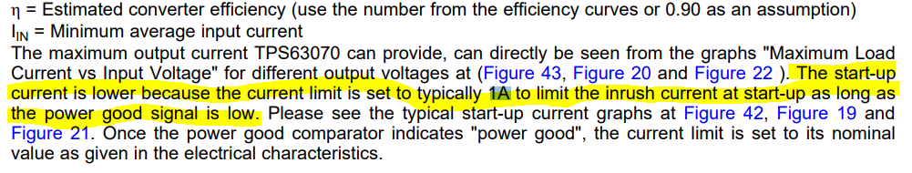

I have a contact using the TPS63070 in a Buck-Boost configuration and there is a Rload_crit value that is described as the "Minimum Rload Required during Start-Up". This value appears to vary quite a bit with adjusted parameters and we are wondering how the value for this parameter is determined?
I consulted the datasheet but all I could find about minimum start-up load was:
Thank you,
