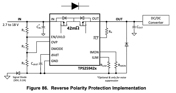

On the Reverse Polarity Protection (figure 86 from the datasheet, see below), a diode connected to the output and the return path is needed.
  • Is this diode a part of the Reverse Polarity Protection?

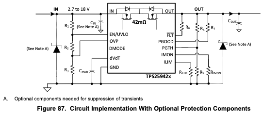

  • Is it a protection against inductive effect of the load (related to the Schottky diode from the figure 87)?
  • can you give me some requested characteristics of this diode?
Thanks for your help.
