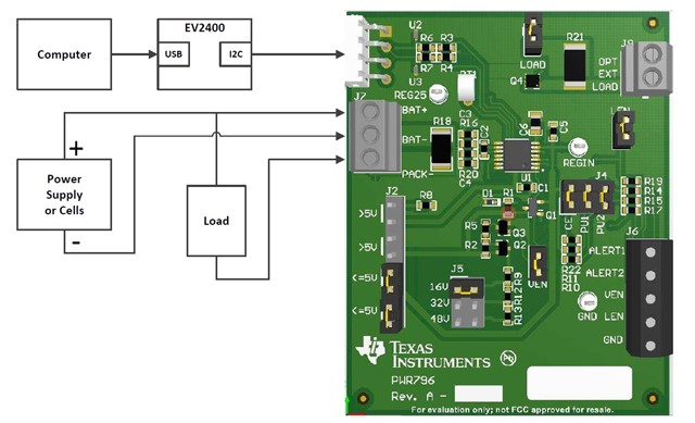

I am trying to calibrate the offset CC of my BQ34110 chip using its EVKit and via Bqstudio and I get this error message :
" Current flow across sense resistor." :
I know that the gauge offers CC Offset and Board Offset calibration options to zero any residual current that may be
reported by the gauge. Thus, these calibrations are only required if the gauge does not report 0-mA current
when no current should be present.
But I don't understand where this current across a sense resistor comes from and how to solve this problem ?
Is it because I have kept the load connected to the battery which induces a non-zero current ? I have made exactly the same connection as recommended in the user guide:
Thanks for your help !
