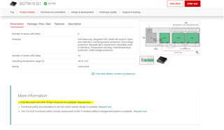

    Ps: I cant seem to find that request button for the bq79616- could you please post a screenshot?
  • Lukasz,
    Here is how to find the request button: Sorry I dont think we have any document explaining this but it should be straightforward depending on your needs and timing to enable the FETs when you desire in a loop of some kind.
