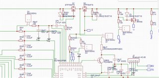

    I have set the Power_config register as recommended, but I  see a very little boost on MOSFET gates. Let me share with you the results of my test, where I sent only the following commands.

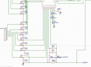

    When both FET turn-on subcommands are sent, gate voltages are dropping down. I think the charge pump is unable to boost both of them at once. Can a defective BJT cause this problem? ( Find my schematic below). The voltage difference on the CP1 capacitor is around 10volts is this ok?

    On your schematic it looks like Q3 is backwards. That means the gate of the DSG FET will only be a diode above the source when the DSG pin is high. The voltage on the CP1 cap sounds okay - it is typically around 11V.

    Thank you so much, After eliminating q3 from the circuit gate voltages are perfect. Just one final question.
