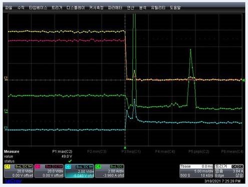

  • Hi Rakesh,
    please check the waveforms below ;
    CH1 yellow : GATE
    CH2 red : Vout
    CH3 blue : Ctimer
    CH4 green : Iout
    as you know, this IC is completely dead after each short test. this test is a huge burden for my customer.
    please check this issue. Thanks.
    Chase
  • Hi Chase,
    During short, L3 causes kick-back voltage which is not well captured in the above test waveform. Use TVS diode 5.0SMDJ54A at the Vin pin of IC to clamp the transient voltages e2e-uat.ti.com/.../selecting-tvs-diodes-in-hot-swap-and-oring-applications
    Use PSMN4R8-100BSE for Q15 to have better SOA margin.
    Best Regards, Rakesh

  • Hi Rakesh,
    It took a long time to get the parts for test.
    the result is, it is all the same even I changed FET and diode, waveform is same too.
    could you tell me other points to check?
    also I want to tell that when LM5066 is broken because of the short output circuit, PCB routing in front of SENSE pin (#3) burns out.
    I think it is related on this matter.
    Chase

  • Hi Rakesh,
    Thank you for your reply.
    fortunately they solved the problem themselves. it was because of the L3 inductor.
    after removing L3, hot-short protection is working well.
