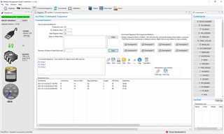

Hi team,
Good day.
Our customer is using the BQ76952EVM and was reading current and voltage data in bqStudio. For voltage data of Cell1 after querying  0x14, the hex receive matches the actual voltage on the cell but when they reading the current data under CC2, by querying 0x3A the data bytes for -5200 mA currents, they get 87EB instead of EB87. Is the configuration correct? Here is the screenshot.
