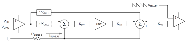

I see that there's a proportional path named ‘ACLL’ in compensator, being combination with integration 'INT' path, together as 'PI' control in loop. Changing KP/KI can shape loop gain curve easily.
However, it is well-know that 'ACLL' has its own definition from processor vendor, when 'DCLL' equals to zero, ACLL(transient load-line) can be used to describe ΔV/Δi during transient.
This physical meaning is also named AC droop somewhere.
My question is:
When loop is always linear at load transient, can I directly calculate that undershoot//overshoot ΔV = ACLL*Δi ?
