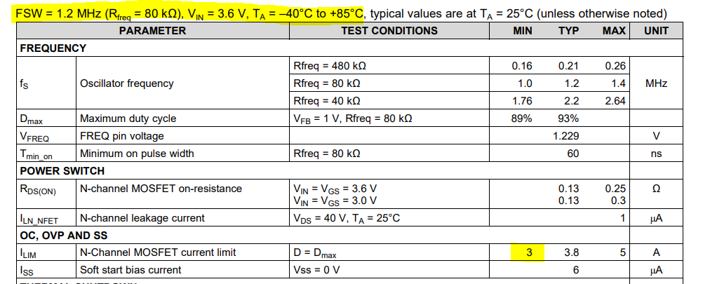

I have a question about the Current Iimit of TPS61175.
In the data sheet of TPS61175, the minimum value of N-Channel MOSFET current limit is described as 3A, but if you look at the conditions, it is described as "FSW = 1.2 MHz (Rfreq = 80 kΩ), VIN = 3.6 V, TA = –40°C to +85°C".
If this is the following condition, will the minimum value of the N-Channel MOSFET current limit be lower than 3A?
・ Vin = 2.9V to 18V
・ Fsw = 200kHz to 2.2MHz
・ Ta = -40 ℃ to 85 ℃
・ D = Dmax or less
I would like to know the worst case of N-Channel MOSFET current limit, so I would be grateful if you could let me know.

  • Hi Ottey,
    The duty cycle will have an effect on the switch current limit. The switch current limit vs. duty cycle curve is shown in figure 4.
    The input voltage, switching frequency has little impact on the switch current limit.
    However, our device won't test at full Vin range, duty cycle range because it costs too much effort.
    Please leave enough margin in your design to avoid triggering current limit.
    Hope that helps.
  • Hi Zack
    I understand that the value of the Duty cycle changes the current limit.
    Can the N-Channel MOSFET current limit fall below 3A when the duty cycle changes?
    (If possible, I would be grateful if you could tell me the minimum value of the Current limit when the Duty changes.)

  • Hi Ottey,
    For your application, the input is 6.3V, output is 11.4V, Iout is 1A, if setting the switching frequency at 600kHz, L=6.8uH, the calculated inductor peak current is around 2.3A. So it has 700mA margin.
    The duty cycle in steady state is ~48%. Per below switch current limit VS duty cycle curve, during load transient, the duty cycle will increase so current limit increases a little bit. You don't have to worry about it.

    When designing with TPS61175, I am thinking about designing so that it does not exceed the minimum value of the following N-chanel MOSFET Current limit.
    In the table below shown in the data sheet, the minimum value of N-chanel MOSFET Current limit is 3A when D = Dmax.
    Should I design it so that it does not exceed the minimum value of 3A of the N-chanel MOSFET Current limit described in the data sheet even if it becomes the value of other duty cycles (D ≠ Dmax)?
    Y.Ottey
  • Hi Ottey,
    The switch current limit also has relationship with duty cycle shown in Figure 4. For your design, you don't have to be worried about it because there is 700mA margin.
