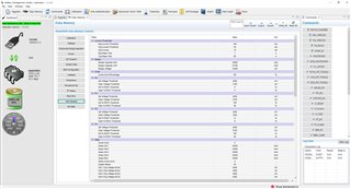

  • Thank you for your kind advice.
    Additional explanations and photos are attached.
    First of all, I would like to change the full charge capacity to 10500mAh.
    As shown in the picture, we have also changed the Design Capacity and Qmax to 10500 and confirmed the change by pressing Write_All and performing Read All. However, as you can see in the picture, the capacity of Full Charge Capacity is changed to 8394mAh instead of 10500mAh.
    Also, our Battery Pack 4S3P COV is 17.0V.
    If the OCD is operated at Pack Voltage 16.4V, CHG ON or DSG OFF. (Normal operation) If the charging current is applied (Approval condition 16.8V/1A) to release the OCD, it will not be released (Release condition is 200mA or more charging current).
    However, if the charging current application condition is changed to 17.2V/1A, the charging current is applied to OCD Release, but I wonder why the charging current is not applied at 16.8V.
    Please advise if there is any setting I need to check.

  • Hi SeungMin Choi,
    You cannot change the full charge capacity, this is something that is calculated by the Impedance Track algorithm. Full charge capacity is usually less than the design capacity, especially as the battery ages.

  • SeungMin,
    1) FCC is a function of QMax + IR loss. Not DesignCapacity. Design capacity plays no role in the mAh your battery can produce. IR loss is determines based on the Ra table (resistance) and current (load select) within the gauge simulation. Please update the QMax value then follow the "learn cycle" application note on the bq40z50 ti page.
    QMax is a parameter that is constantly updated by the gauge and should go down overtime at the gauge ages.
    2) OCD stands for Over current discharge. You can modify the recovery threshold lower to recover based on less current applied. you can set the value to 0 to it recovers when the dsg current is removed.
