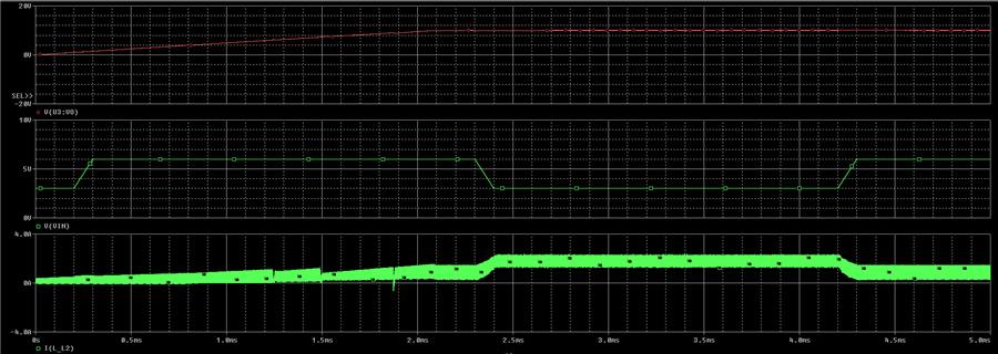

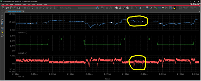

I notice dips in the switch current and output voltage when running the PSpice model on the TPS61378 web page.
This is strapped for FixedPWM on the mode pin (high) so the behavior is expected to be smoother.

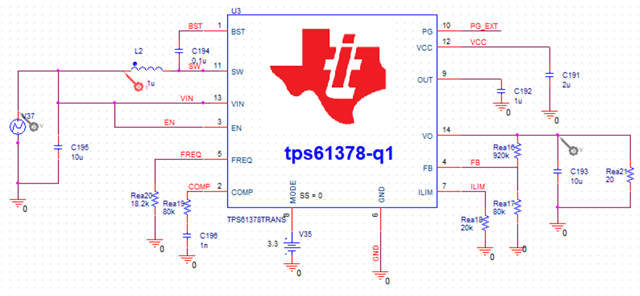

I have configured a toggling input 3.2V/6V and set output to 10V/500mA.
Please explain what we see here for 6V input:
