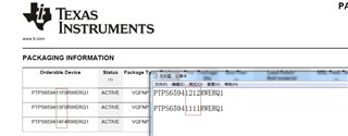

TPS6594-Q1: What does the middle four digits (in the red box) mean in 1111 and 1212
Part Number: TPS6594-Q1
Hi Team,
The one on the left is in the datasheet (there is no latest specification), and the right is the what customer has received. The middle four digits are different. What does the middle four digits (in the red box) mean? What are the coding rules? Thank you.
  • Hi, Amelie,
       Please see answer below:
    • Digit 1:  SoC supported
      • 1: TI
      • Others: Non-TI
    • Digit 2:  Buck 1 to Buck 4 Configuration
      • 1: 1 Output 4p
      • 2: 2 Output 3p+1p
      • 3: 3 Output 2p+1p+1p
      • 4: 4 Output 1p+1p+1p+1p
      • 5: 2 Output 2p+2p
    • Digit 3 &4
      • NVM version
    Thanks!
