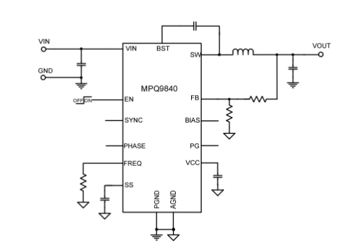

I want to use LMQ62440-Q1 to replace MPQ9840GL-AEC1. Could you provide a comparison table between the two?

    36V, 3.5A, Low IQ, Synchronous Step-Down Converter AEC-Q100 Qualified
    Description
    The MPQ9840 is a high-frequency, synchronous, rectified, step-down, switch-mode converter with built-in power MOSFETs. It offers a very compact solution that achieves 3.5A of continuous output current with excellent load and line regulation over a wide 3.3V to 36V input supply range. The switching frequency can be programmed or synchronized to an external clock in the range of 350kHz to 2.5MHz. The synchronous operation and ultra-low 14μA sleep mode quiescent current provide high efficiency over the output current load range, allowing the MPQ9840 to be used in a variety of step-down applications in automotive input environments and battery-powered applications.
    Peak-current-mode operation provides fast transient response and eases loop stabilization. The excellent low dropout performance allows the MPQ9840 to be used in high duty cycle applications.
    Full protection features include over-current protection (OCP), short-circuit protection (SCP), and thermal shutdown. An open-drain power good (PG) signal indicates when the output is within 10% of its nominal voltage.
    The MPQ9840 is available in a space-saving QFN-16 (3mmx4mm) package.

  • Hi Kygo,
    Please see preliminary comparison below:
    Some highlights are that LMQ62440-Q1 has lower internal FET Rdson meaning there will be less conduction and switching losses compared to competitor MPQ.
    LMQ62440-Q1 MPQ9840
    VIN Range 3-V to 36-V  3.3-V to 36-V
    IOUT (rated) 4A 3.5A
    Frequency range 200kHz to 2.2MHz 350kHz to 2.5MHz
    Internal FETs (High-side/Low-side) 41mΩ / 21mΩ 125mΩ / 55mΩ
    MODE ADJ (FPWM and Auto/PFM) ADJ (FCCM and AAM)
    Size 4 mm x 3.5mm  3 mm x 4 mm
    Shutdown current 0.6uA (typ) 2uA
    No-load quiescient current 7uA (3.3V) ; 10uA (5V)  14uA
    Features Integrated HF caps, BIAS, RBOOT, Spread-Spectrum, PG, SYNC BIAS, External SS, PG, SYNC
    Hope this helps give some insight on our TI LMQ62440-Q1 versus MPQ9840.
