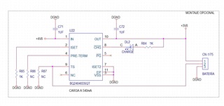

Dear TI,
I send you the schematic of my new design.
I´ve calculated the resistor divider for an Vout of 3.8VDC in the REG2 (TPS7A7002DDA), but I always get 4.26VDC in Vout of REG2.
I´ve changed R3 by 200K (Vout=3.5VDC) and Vout is 4.26V also.
I need help please.
Regards.

    The schematic you attached is very difficult to read as it seems to have been uploaded with low resolution. Can you reattach one with better resolution? I tried zooming in and I can't make out enough to assess the schematic. It does sound like a systematic issue since it is on multiple boards and so may not involve board contaminants.
    Is this a DC 4.26V measured on a DMM or did you check with a scope? It would be good to know if the scope shows an oscillating output or not. A scope shot showing Vin, Vout, Ven, and Iout (if possible) could be very helpful with the schematic.

  • Hey Javier,
    Thank you the schematic is now clear and I don't see any concerns with the schematic, it looks ok. It is interesting that you change R2 and you get the exact same voltage on the output. Is there current flowing from the LDO to the load?
    What did you mean by "I have checked the PCB and seen that R3 is linked to the 3V8 plane instead of pin 6 per track. I have R3 attached per track and I still have 4.26V"? Does this mean that both R3 connections are shorted to the Vout node? I'm wondering if the LDO is in dropout, Vout tracks Vin then we know it is in dropout and we just need to figure out why.

  • Dear Kyle and Stephen,
    I just found out what the fault is and it's not flux contaminants.
    This fault occurs on the boards that have the BQ24040 battery charger mounted and I don´t understand why.
  • Hey Javier,
    Your schematics show the outputs of the TPS7A7002 and the BQ24040 are both listed as +3V8. Are the outputs of these two devices connected? If so this is the cause of the behavior that you are seeing. Looking at the BQ24040 datasheet it appears that it outputs 4.2V, so if that output is tied to the LDO's output then the voltage will be the higher 4.2V sincethe LDO does not have a pull down.

  • Dear Kyle,
    It is a mistake in my schematic. I want to make the equipment work with the power supply and if it turns off, let it work with battery. How to connect the battery to system load when power supply turn off? This is my question right now.
    +3V8 is the system VCC.
