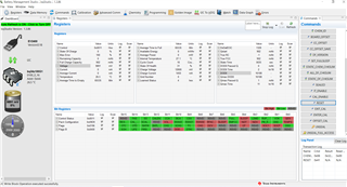

    Please find the attached screenshot of the log
    We carried out the steps as you have mentioned. Discharged the battery to 9V(termination voltage) and did Reset the gauge. [VOK] bit got set to 0, when[OCVTAKEN]bit becomes high, DOD0 and QMAXDOD0 values are 16108 and 16107 respectively.
    Please find the attached BQStudio screenshot
    We did not understand at which point, QMaxDOD is not satisfying the 90% DOD update needed to get the initial QMax ?
    Please help us to understand this so we can carryout learning cycle from the beginning.

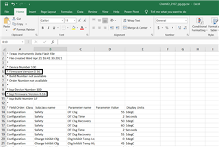

    Something is wrong with your log file. For update status to go to 0x05 you must get a qmax update. The first QMax update requires you get 90% change in DOD between your two rested points. DOD is a value that ranges from 0 to 16384 based on the chemID. You log file has this value as 14k-36K which cannot happen.
    The log file seems to be exported using v1.06 while the gg file is v0.16. Please re-run the test using the correct version of bqStudio so we can correctly analyze the log file. bqStudio should auto-detect when opened if you have the right one.
    Eric Vos
  • Hi Eric,
    When we are opening the log file and gg file, we are observing same FW version as 0.16, Please find the attached images.
    Even when we are reading FW_VERSION from BQStudio it is showing 0x0016.

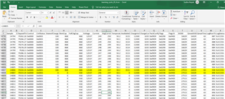

  • Hi Eric,
    Thank you for the confirmation.
    We discharged the battery till 8V and relaxed it for >5Hrs and we have seen DoD values as 16024. Then we charged the battery till 12.6V and once charging current reduces to taper current level we will stop charging and let it relax for >2Hrs, however when charging current was dropping , Full charge capacity value jumped from 869mAh to 930mAh and SOC changed from 100% to 0% because of this FC Status changed to 0 from 1. So update status didn't update to 05.
    Please find the attached log.
    Please help us to understand, what is the reason for this kind of behavior. Why Full charge capacity is suddenly changing?learning_cycle_29_4.csv
    Sudha Nayak

  • Hi Eric,
    What might be the reason for Full charge capacity value jumping from 869mAh to 930mAh and SOC changed from 100% to 0% ?
    Looking forward to hear from you at the earliest.
    Sudha Nayak
  • HI,
    Please find the attached log file screenshot, where we can see SOC changed from 100% to 0%.
    Sudha Nayak
  • Hi Eric,
    We are charging the battery at 1A. IS this is the reason for sudden drop in SOC? Should we reduce the charging current?
    Can Higher temperature cause this kind of behavior?
    Please help us to understand why SOC is suddenly dropping to 0%.We have already invested so much of time in learning cycle and still not able to complete it. This is blocking our further implementation.
    Sudha Nayak
