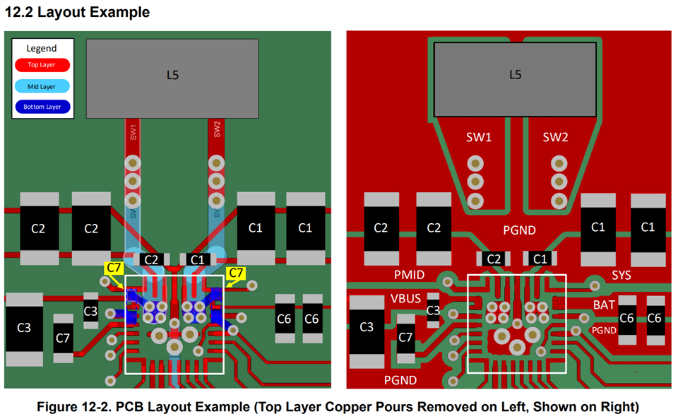

  • Hi Cyril,
    With the exception of the SCL/SDA lines being pulled up to REGN, your schematic looks reasonable.  We have not tested and therefore can't recommend those pulls being more than 3.3V.   But, I don't that that is your issue.  On your board layout, did you mimic the BQ25792 EVM as shown below?  The PMID and SYS caps positive and GND connections need to be close to the IC PMID, SYS and GND pins.  That means the SWx pins need to route down to internal/bottom layer and back up to inductor that is pushed away from the IC.  If those capacitors are not placed like this, the charger will not be able to provide higher output currents in either forward-charge or reverse-OTG modes.
    Jeff
    Jeff
  • PMID and SYS caps are close to IC  but SWx routing is directly through top layer. Will have to test with the recommended routing.
    Thank You.
  • The ground return for the PMID and SYS 0.1uF caps may be the problem.  Our 1st revision of EVM was like your board and had similar problems.
  •  So the return ground needs to be close and directly connected to IC ground. Will design according to the EVM and test and get back.
  • Cyril,
    You may be able to do what we did 1st rev of EVM.  Rotate those 0.1uF capacitors so they are still soldered to PMID and SYS then run a short wire to ground pin from each capacitor's GND side.  That would confirm my theory at least.
