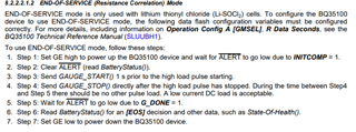

we have BQ35100 used on our custom board for monito battery capacity, this IC Supports lithium thionyl chloride (Li-SOCl2 )chemistry.  As per datasheet we are following procedure method but unable to read correct battery capacity
I have read few posts - if CHEM ID is not properly loaded then we will not get correct battery EOS
Right now I am using SAFT LS33600,  What is chem ID for this Battery?
How can i generate CHEM ID for this battery  and How to program CHEM ID without evl kit
