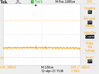

I am using three TPS61169s to drive three strings of 5 RGB LEDs. The respective string voltages are R=10.8, G=15.7 and B=14.6 volts, and I chose feedback resistors of R=.47, G=.56 and B=.68 ohms to give string currents of R=425 mA, G=360 mA and B=325 mA. I am using the circuit on page 1 of the data sheet with L=6.8 uH, Cout = 1 ufd, Cin = 10 ufd, and the Schottky diode is rated at 40V and 500 mA. I've attached a screen shot of the layout and the driver schematic. In the layout, the red channel is on the left, the green in the middle, and the blue is on the right. The PWM frequency is 10 kHz.
The channels for the three colors have the same layout. The blue channel works properly. However, while the red and green channels respond to the PWM input, the maximum currents are 1.25 and 1.35 A (which looks like the current limit for the TPS61169), regardless of the value of the feedback resistor. I have built several boards and they all do the same thing, so this appears to be a design problem.
Please suggest what might be happening and how to correct the problem.
Also, in the event that the TPS61169 is an inappropriate choice for this application, please suggest alternate parts. I have used the LM3410 in the past on other projects; is this an acceptable alternative?
