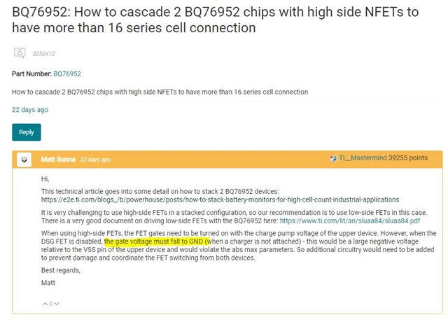

I am trying to stack two bq76952 together for a 32S BMS design with following design considerations:
  • Upper IC will be operating with VSS referenced to the top of 16th cells
  • SRP and SRN of the top IC will be shorted
  • Upper IC will drive the high side DFET, CFET and PDSGFET of the combined battery pack
  • DDSG and DCHG signals from lower IC will feed the DFETOFF and CFETOFF input of upper IC through isolators for communicating faults
However in one of the posts it is mentioned (as in the screenshot below) that gate voltage must fall to GND for proper operation of high side MOSFETs. Can it be possible that the gate voltage of high side MOSFETs falls to VSS of the upper IC (i.e. top of 16th cell) for safe turn ON and OFF of the MOSFETs. As per my understanding, zero VGS voltage must be enough to turn OFF the high side MOSFETs.

  • Hi Manuj,
    I have seen other users stack two devices, but they usually use low-side FETs do to the complications using high-side FETs with a stacked solution.
    A more detailed description of the DSG FET driver for the BQ76952 is shown in Section 16.5 of the datasheet. The DSG pin will eventually get pulled well below VSS of the top device since it will follow the PACK+ voltage (which will go to GND of the system).
