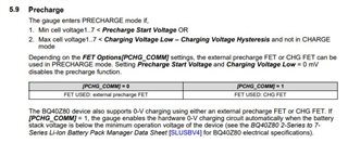

will the BQ40Z80 allow 0V charge?
meaning, the PRECHARGE start voltage is set in the data memory flags.
but when the IC doesn't have enough voltage to operate, say VCC= 1V to 5V, will the precharge path stay open by default?
if yes, and I want to prevent that, is there any course of action I can take?

    The BQ40z80 does support 0V charge. Please see the snippet from our TRM below.

  • thanks Jessica,
    allow me to quote:
    "The BQ40Z80 device also supports 0-V charging using either an external precharge FET or CHG FET. If
    [PCHG_COMM] = 1, the gauge enables the hardware 0-V charging circuit automatically when the battery
    stack voltage is below the minimum operation voltage of the device"
    when choosing PCHG_COMM = 1 , the CHG FET will allow the precharge current.
    how can the CHG FET allow 0V charge, when there is no voltage to drive the FET?
  • Hello Ran,
    The voltage is supplied by the adapter, a lower voltage is applied to the FET gate so the battery is trickle charged, this is to prevent damaged to the battery.
    Sincerely,
    Wyatt Keller
