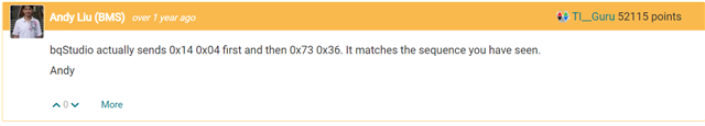

  • Hi Rohaan,
    Maybe this thread will be helpful: https://e2e.ti.com/support/power-management/f/power-management-forum/877582/bq34110-security_keys-write-format
    The byte order appears to be reversed in your capture.
    Matt
  • So that link was actually helpful thank you, This particular statement was what helped me  From that I got the the sequence i needed to send the keys in but it was still not working. I randomly decided to put a 10 ms delay between the two words and that allowed me to unseal. The delay seems to be crucial as I tried it without and it would not work. I have not tested higher delays than 10ms.
