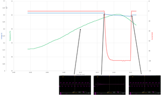

i do have a project with the bq25886 charger. Up till now the charger does what it should.
While temperature change tests i saw a bahavior i could not explain (and no information could be found in the datasheet). This is what i have done:
  • RT1/RT2 values choosed based on datasheet (5.24 and 30.31 kR) = (charge temperatures: 0 ... 60 45°C)
  • temperature change test in climate chamber -20 ... 60 °C
  • battery is fully charged at test begin
  • device is powered by external supply all the time
my assumption was:
  • the charger will report charge error while temperature is below 0 °C
  • battery will stay at 100% RSOC because the device will allway's live from the external power supply
What i found was this:
  • green: battery temperature
  • red: battery current
  • blue: battery voltage
so it could be seen:
  • the battery is discharged at temperatures from ~40...60°C -> device lives from battery
  • discharge at high temperatures (60°C) is stopped -> device lives from external source
  • recharge battery if temp is lower than 45 °C -> device lives from external source
  • no discharge at low temperatures -> device lives from external source
  • ... and repeat...
The question is: Why does the charger discharge the battery at ~40 ... 60 °C if always a external source is available ?
My guess is:
  • The build in JEITA Mode is the reason
  • normally the charge voltage is set to 8.4 V (=full battery), but at high temperatures the JEITA mode T3-T5 reduce the max voltage to 8 V (datasheet 8.3.7.4)
  • if the charger enters T3-T5 of the JEITA mode but the battery is at 8.4 V, the voltage is to high for the charger and it starts to discharge the battery to bring it down to 8 V
  • because of my fast temperature change test the charger leaves T3-T5 of the JEITA mode after a short discharge periode and recharge the battery because 8.4 V max voltage is set again

  • Hi, i have performed a new test:
    The Switch-Node wave form does changes significantly when the temperature is above ~43 °C (and does change back if temperature is low enought).
    Additional i observe PG# and STAT:
    • PG# is always 0
    • STAT is 1 if Temperature is below ~43 °C and flashes while temperature is above ~43 °C

    i dont think this is the answer. Here is why i think so:
    • The battery is at 100% RSOC at test begin -> no charging
    • STAT Pin indicates 1 if temperature is lower than ~43 °C (=charge complete)
    • The device was in a climate chamber with 40 °C ambiente temperatur -> its far to cold for thermal throttling based on the DIE temperature
    • SW-Node wave form is different for charge/discharge/full
    Charge (~ 7,5 V battery voltage):
    charging
    Battery full (~ 8,4 V battery voltage):
    Battery full
    Discharging (~ 8,4 V battery voltage):
    discharge Idischarge II
    Best regards
    Andre

    i had monitored the temperature of the charger (not DIE but top case temperature) in my testcase from my first post:
    So the max temperature of the charger was ~62 °C (You can even see when it is recharging the battery by the small spikes).
    Because the charger has nothing to do (no or little current most of the time) the DIE temperature should be really close to the case temperature.
    > Not thermal problem.
    Best regards
    Andre

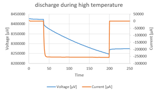

    I have made further tests:
    Test A) 45°C Ambient:
    parameters:
    • batteries fully charged (8,4 V)
    • ambient set to 45 °C (for the whole test)
    • powersupply always available
    testcase:
    • run test as long as the discharge continues (=what is end-voltage for discharge-behavier?)
    result:
    • Discharge stops at 8,25 V
    Test B) 45°C Ambient, RVSET=160kR
    parameters:
    • RVSET changed from 470 kR to 160 kR (closer to datasheet min value for 8,4 V charge voltage)
    testcase:
    • run test as long as the discharge continues (what is end-voltage for discharge?)
    result:
    • same behavior as in test A (Discharge stops at 8,25 V)
    Test C) 45°C Ambient, RVSET=15kR
    parameters:
    • RVSET changed to 15kR (= 8,2 V charge voltage)
    • batteries fully charged (now 8,2 V)
    testcase:
    • run test as long as the discharge continues (=what is end-voltage for discharge?)
    result:
    • no discharge observable
    Test D) only heat up charger NTC
    parameters:
    • ambient set to 22 °C (room temperature for the whole test)
    • RVSET= 470 kR
    testcase:
    • only heat charger NTC to 50 °C (no other part) with hot air gun
    result:
    • if NTC is at 50 °C: discharging
    • if NTC is at 22 °C: no discharging
    At the moment this looks like the charger does fall back to the lowes possible charge voltage when the NTC temperature is above 45 °C and than discharges the battery as long as ~8,2V is not reached. (safety reason - batterie voltage to high!?)
    I can't explain this behavior, but I can reliably reproduce it.
  • Hello Andre,
    The charger will prevent charge whenever the temperature is above the max temperature you set according to the JEITA profile. It will still discharge the battery at the higher temperatures which is what you see from the tests.
    It seems like the real question is if the charger should be switching to provide VSYS when the battery is over temperature?
    Sincerely,
    Wyatt Keller
  • Hello Wyatt,
    V_SYS is fine all the time from -20 up to 60 °C (no matter whether it comes from the battery or the power supply).
    Also the behavior itself was not a problem for me. But I needed to understand why it was happening to identify possible other effects.
    Now that i have the explanation (JEITA) i am ok with it.
