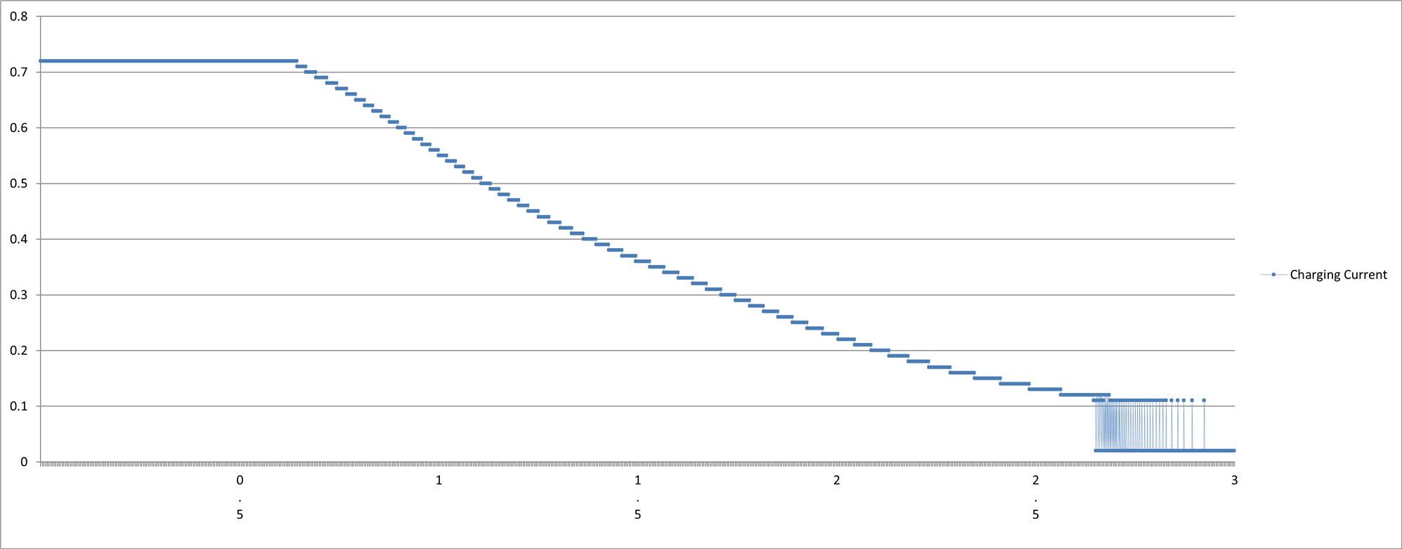

Hello TI experts,

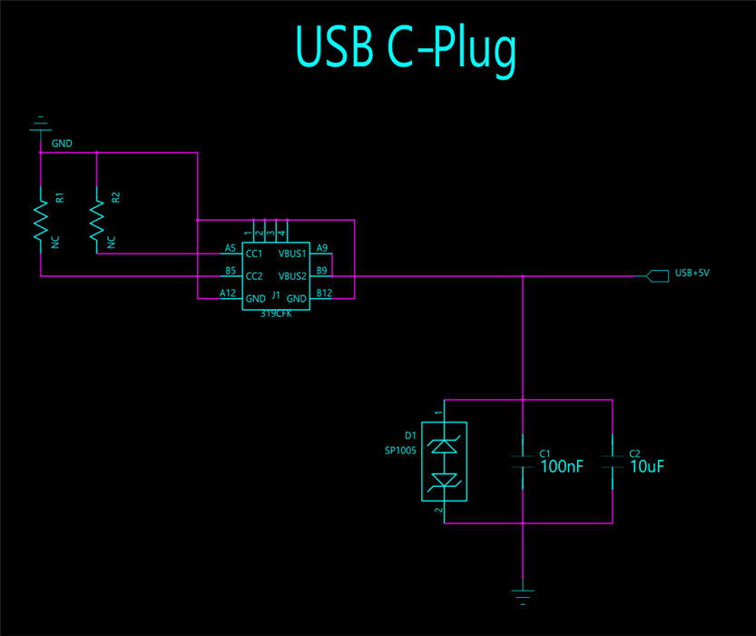

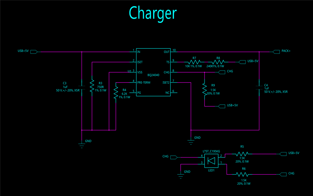

about 1 month ago I asked about the review of the BQ24040 schematic;
https://e2e.ti.com/support/power-management/f/power-management-forum/983721/bq24040-please-review-the-schematic
now they made their own PCB and test it.

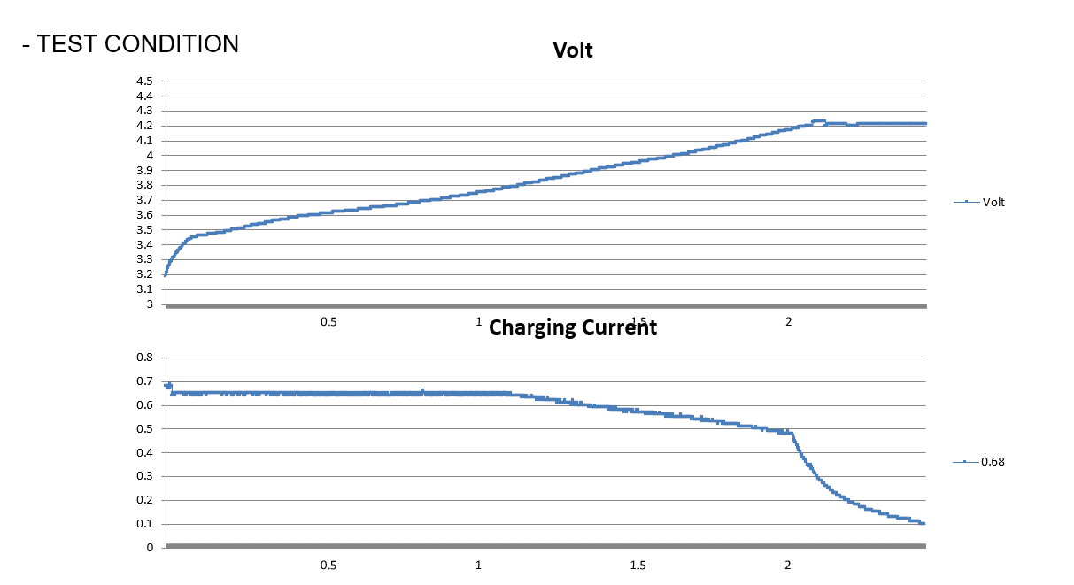

and we checked that the charge current is 790mA and termination current is 59mA.
we saw that \CHG pin turned to open drain around 59mA.
the problem is, i expected that charging current would be fall to 0A right away after \CHG pin turned to open drain.
(please see figure 8.1 in datasheet.)
but the charging current is still about 59mA, and it decreased slightly down until it reaches to 0A.
and we saw this in EVM too.
is it normal operation? or do we something wrong?
please check this issue. Thanks.
