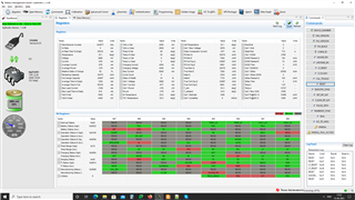

Today I encountered one strange problem where LStatus Changed - 0x02 to 0x06 once I enter the Gauge Enable command for starting the learning cycle.
Here I have attached the screenshot of BQ studio.
PS: Previously I have flashed 25000mAH golden file on this set-up for validation & testing purposes and now I have started the learning cycle for 30000mAH on the same set-up. I have modified the data memory as per the 30000mAH battery pack datasheet & write the same in the BQ27Z561.
Let me know how to overcome this issue.

    The update status field is just an indication of the learning process.
    [Field QMax][IT Enabled][Resistance Learned][First QMax Learned]
    sending IT-Enable command flips bit 3. So if you are at 0x02 it will go to 0x06 with the command being sent.
    I suggest starting with a fresh image then updating your needed registers for the new pack

    If you are doing a learning cycle on a new battery you should use a default configuration for the gauge to reset the update status. You can upload the default .srec to clear everything back to factory to run a new learning cycle.

    1) The different variants on TI.com are just preprogramed devices. You can flash any version on the silicon. The R0, R1, R2 will all run on any of the base devices.
    2) You can take your already produced golden and flash it in.
    3) bq.fs is the full firmware image. THis will update your from R1 to R2 for example. The df.fs file only updates the datamemory section of the device. You should ONLY use df.fs if the device is already programmed with the right version and build.
    4) Please look in the software development page of each product.
