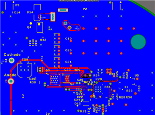

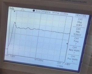

I designed controller and cannot get it to pass EMC. I have tried adding ferrits to input and output wires, changing CBoot, and adjusting values of the snubber capacitor and resistor. I am out of ideas of what else to try. I realize now that the vias in the SW Node need to be removed and the trace needs to run on the top layer. Scraping the copper off the bottom layer and cutting the bottom trace and replacing it with a wire on the top layer did not make a difference. I have also added smaller caps to decouple the input and output caps of the regulator with no affect. There is ringing in the switch node that I am not able to suppress further. I have shutdown all other subsystems on the PCB so the noise is coming from this part. Please let me know if you require additional information. Thank you for any assistance you can provide.

Switchnode (Probe 10X)

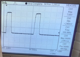

High side gate to source

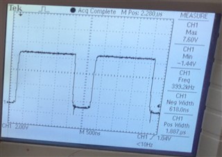

Low side gate to source

  • Hi Daniel,
    As you mentioned, the SW copper and vias should be minimized, and the high dv/dt traces (SW, LO, HO) should be routed internally. See app note snva803 for power stage layout best practices, especially in terms of input cap placement where the GND return is routed below the FETs to minimize the power loop parasitic inductance.
    My recommendation here is to remove the external VCC connection and run from the internal 7.5V VCC. The implies a lower gate drive amplitude, which will inherently reduce the dv/dt on both the SW voltage and gate drives. Check also that the correct terminal of the inductor is tied to SW (typically the inside of the winding is the dotted end, and this is effectively shielded by the outer turns connected to VOUT).

  • Hello Tim,
    I was trying to follow figure 2 in that document. As for routing the traces, I saw no mention of that in the documents. In the third example, they route LO and SW on the top. I only have 4 planes, Should I be run them in the VCC plane?
    I am not using an external VCC connection. Those parts are DNP. I left them there in case I needed to to do. As for the inductor, there is no internal winding, it is only a stack going upwards. https://datasheet.ciiva.com/22680/1681984-22680336.pdf?src-supplier=Element14

  • Hi Daniel,
    This is a very large, unshielded inductor with a large radiating area. For 10uH /~10A, it's possible to find a more compact/shielded design. At the very least, ensure that the lower winding turn is tied to SW. Take a look at the LM5145 datasheet for PCB layout guidelines as that has more relevant detail compared to the LM5117 documentation.
    By the way, what is the VCC plane here? Typically, GND is a better option as it is adjacent the bottom layer (which faces the EMI table). One option is to cover the radiating copper or vias with a large electrolytic cap (for example an input cap for damping, etc.)

  • Hi Timothy,
    How do I tell if an inductor is shielded. The title of the datasheet is "Shielded Power Inductors - SER2900" what do I need to look for. One of the reasons I choose that inductor is thermal issues, the size pulls heat from the low side fet which was getting super hot when I used a smaller one. I checked and the lower winding is connected to SW.
    As for the LM5145 documentation, yes that is what my design follows. The component placement is as close as I can make it to the example , particularly in the power section. I am not able to place components on the solder side. One thing I can do is move the controller closer to the switches but not by much. There are also minor errors with the vias for the gate drives. They are 16mil instead of 20mil but I have two of them.

    I am sorry but I don't follow covering up the radiating copper or vias with copper. Am I not doing that?
    Daniel
  • Daniel,
    The idea is to cover up radiating surface with an electrolytic cap to provide shielding - we use this technique in the LM25149-Q1 EVM. Even ceramic caps over a radiating via provides some benefit. However, the dominant effect here is likely the inductor. A shielded inductor has a winding surrounded by core material - see the Coilcraft XAL1010-103 molded inductor as an example. This is much smaller and should provide significant benefits in terms of the radiated signature.
