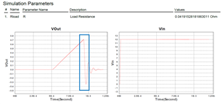

I simulated the TPS543C20A with Webench.
The measurement conditions are Vin = 11 ~ 13V, Vout = 0.85, Iout_max = 20A.
At this time, it will drop before Vout reaches 0.85.
Could you please tell me the cause?

How much output capacitance is there? The output voltage appears to be rising faster than 1.75V/ms and there is 16.7A of resistive load on the output.
Are you setting the Output Current Limit in the WeBench simulation?
Hi Peter James Miller -san,
Output capacitance is 560uF.
After changing the OCP threshold from 24A to 35A, I got Vout = 0.85V.
